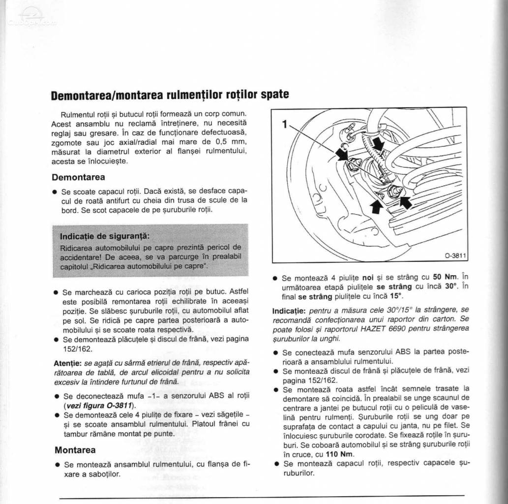

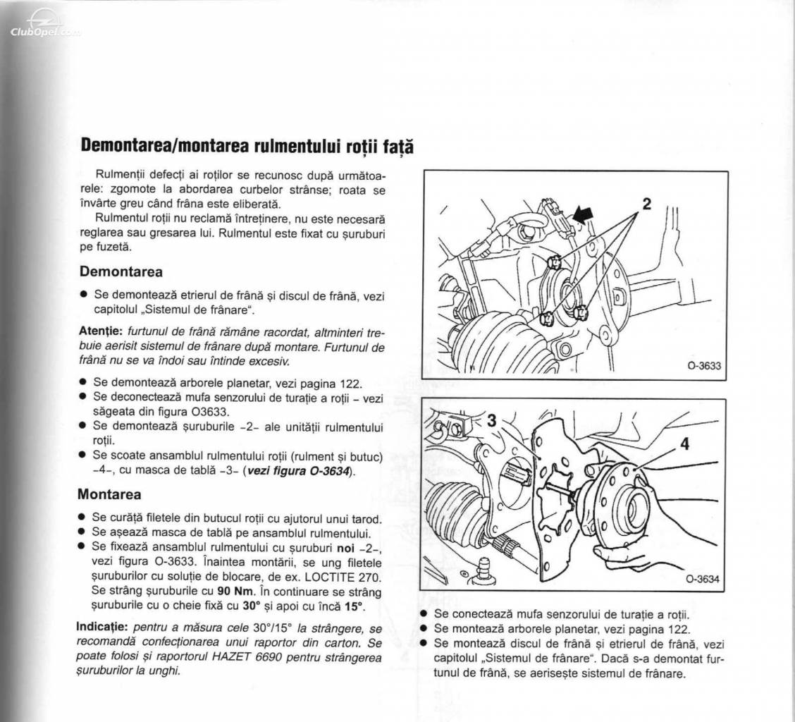

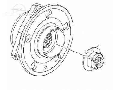

  • T.ion
  • Mesaje scrise: 3,454
  • Masina: Zafira 2001 Z16XE
01 Unitate control ABS
02 Unitate control ABS
03 Web image
04 Fata
05 Spate
