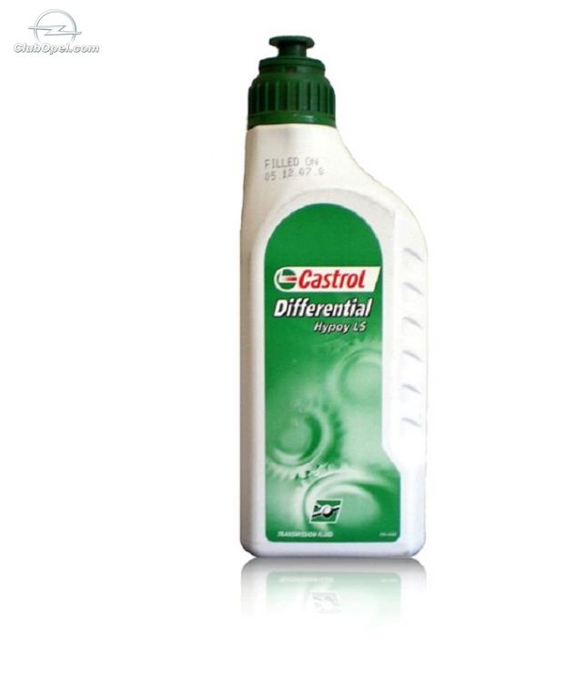

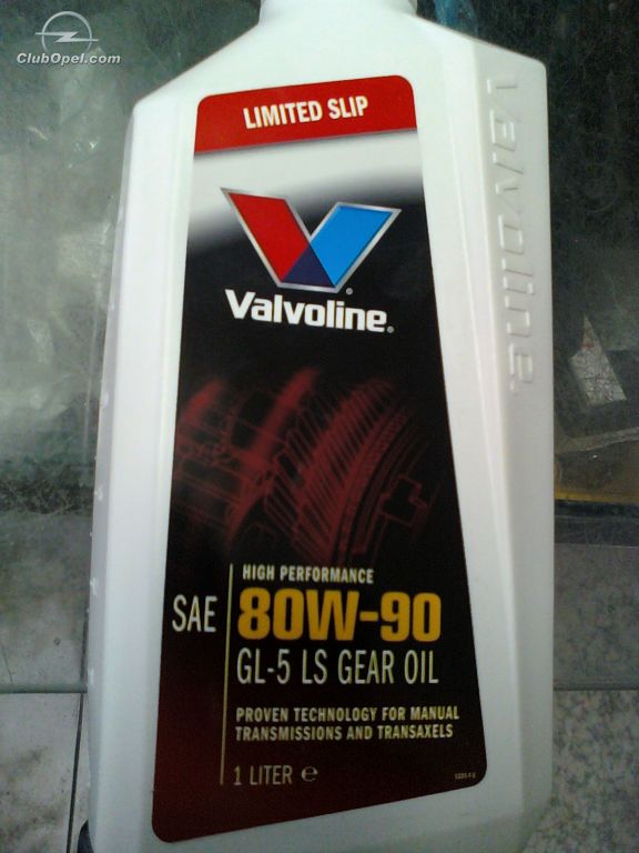

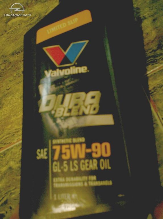

Momentan am gasit si comandat Valvoline 80W-90 GL5 LS dar sunt curios daca acel Castrol EPX 90 este tot pentru LSD (pt frontera...)
- stelea
- 1,721 mesaje
- din 19 Nov 2006
- Frontera 1996
- Dambovita
stelea
- Mesaje scrise: 1,721
- Locatie: Dambovita
- Masina: Frontera 1996
- Cont inregistrat: 19 Nov 2006
Castrol Hypoy LS
Mineral based, SAE 90 extreme pressure gear oil designed to cope with the special friction characteristics of limited slip differentials fitted to road going cars
Castrol EPX 80W-90
Extreme pressure, multi-purpose mineral oil, designed for the lubrication of spiral bevel, hypoid differentials and manual transmissions where the manufacturer recommends the use of an oil to API GL5 performance level
Daca aceste uleiuri sunt la fel, inseamna ca vanzatorii nostri sunt destepti, iar cei de la Castrol sunt prosti: fac doua tipuri de ulei diferite... dar la fel.
Poza cu EPX nu pun ca il stie toata lumea
