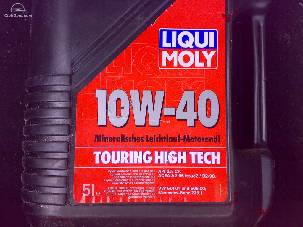

AM UN OPEL VECTRA B DIN 96 MOTOR 1.6 X16SZR 55KW LA CARE TREBUIE SA SCHIMB ULEIUL SI AS VREA UN SFAT ,CE ULEI SA FOLOSESC TININD CONT CA SE APROPIE SI FRIGUL.ULEIUL CARE LAM FOLOSIT PANA ACUM SETE CEL DIN POZA

merge in continuare 10w40.la marca te hotarasti singur.vezi ca exista o discutie de multe pagini legat de uleiuri.

10w40-castrol magnatec, aral,mobil1 amerian,etc
