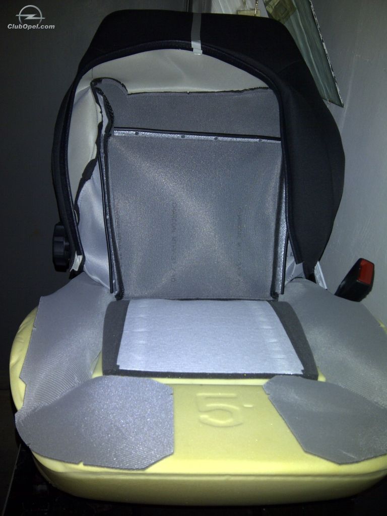

- Dezbracati tapiteria de pe scaun. Este tinuta pe pozitie de inele din sarma de otel. Acestea le desfaceti/cracanati/taiati cu doi clesti Spit. Urmariti pozele.
https://www.dropbox.com/s/tg...0111202-00361.jpg
https://www.dropbox.com/s/f4...0111130-00332.jpg
https://www.dropbox.com/s/vl...0111130-00334.jpg
https://www.dropbox.com/s/iq...0111130-00335.jpg
https://www.dropbox.com/s/8w...0111130-00336.jpg
https://www.dropbox.com/s/6b...0111130-00337.jpg
https://www.dropbox.com/s/sa...0111130-00338.jpg
https://www.dropbox.com/s/vz...0111130-00339.jpg
https://www.dropbox.com/s/tq...0111130-00340.jpg
https://www.dropbox.com/s/cf...0111202-00362.jpg
https://www.dropbox.com/s/0j...0111202-00363.jpg
https://www.dropbox.com/s/yr...0111202-00364.jpg
https://www.dropbox.com/s/ia...0111202-00365.jpg
- Asezati rezistenta pe sezut si/sau spatar si taiat-o cu foarfecul astfel incat sa respecte o forma rectangulara, potrivita cu sablonul de pe buretele scanului.
https://www.dropbox.com/s/x9...0111202-00366.jpg
https://www.dropbox.com/s/j8...0111207-00400.jpg
- Potriviti aripile pe marginea sezutului si spatarului. Eu le-am lipit cu superglue pe alocuri caci nu vroiau sa stea pe pozitie. ATENTIE: NU TAIATI ARIPILE CU FOARFECUL, contin o rezistenta monifilara care se intrerupe daca o taiati.
https://www.dropbox.com/s/k4...0111202-00369.jpg
https://www.dropbox.com/s/hr...0111202-00370.jpg
https://www.dropbox.com/s/n0...0111202-00378.jpg
https://www.dropbox.com/s/0o...0111202-00379.jpg
https://www.dropbox.com/s/4r...0111202-00380.jpg

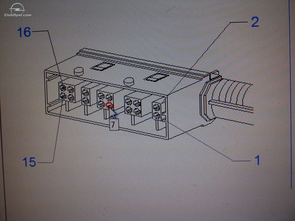

Identificare precablajului.
Conform OPEL TIS, mufa de sub scaun se numeste X48, iar firele pentru incalzire se afla in mijloc, adica X48.3
https://www.dropbox.com/s/un...0111209-00412.jpg
https://www.dropbox.com/s/1c...0111230-00418.jpg
In poza urmatoare, aveti sus mufa tata de sub scaun si jos, mufa mama din podea. Ansamblul facut de cele doua se cheama X48, ce spuneam mai sus.
https://www.dropbox.com/s/d3...0111209-00408.jpg
Daca aveti TIS-ul in fata:
https://www.clubopel.com:808...989_wqys3tngr.jpg
- firul 8 (in poza, mufa 3 sus) este plusul general
- firul 7 este comanda de la buton bord,
- firul 9 este masa, minusul.
Asa arata mufa de sub scaun fara cabluri de incalzire, si apoi cu ele:
https://www.dropbox.com/s/8d...0111202-00392.jpg
Prezenta cablurilor in X48.3 maro+negu/galben+?/?(nu mai stiu culoarea celui de-al 3-lea cablu) insemna ca aveti precablaj pentru incalzire scuane, conform cu aceasta poza:
https://www.dropbox.com/s/d4...0111201-00350.jpg
