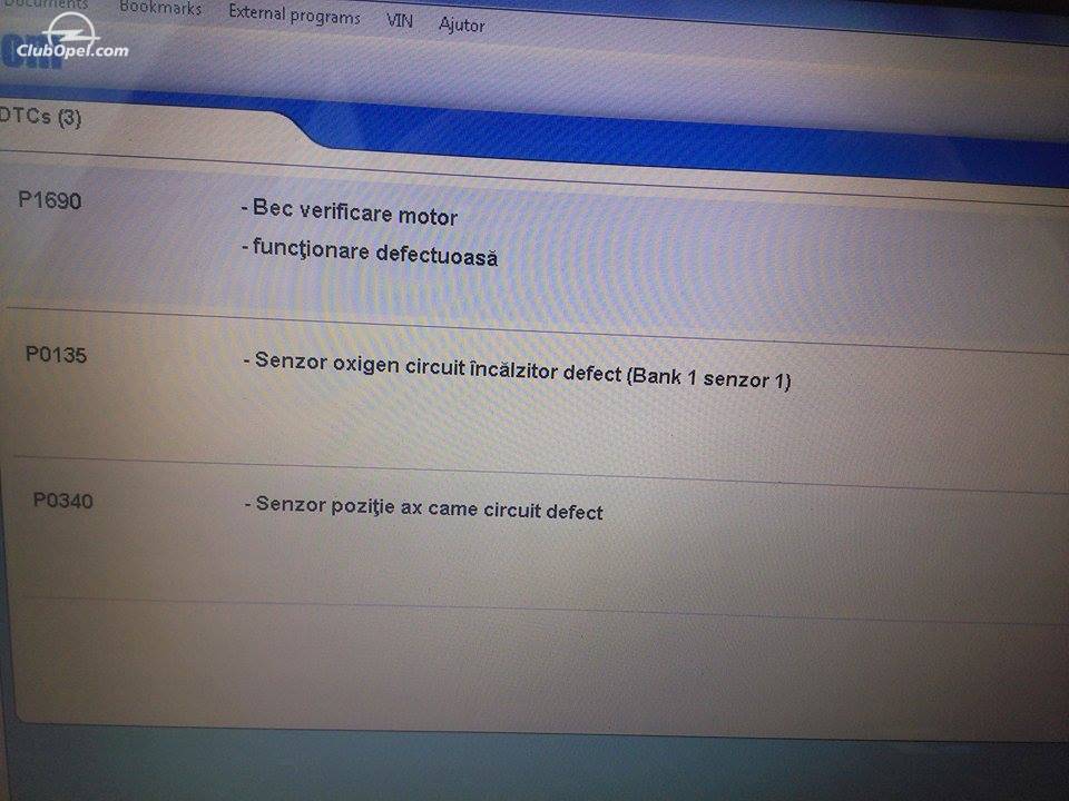

P0135 sonda Lambda 1 circuit incalzire defect--- verifica circuitul (mufa ) sondei ( sau sonda defecta ) -->consum marit
P0340 senzor ax came --- verifica mufa senzor de vreun contact imperfect , circuit senzor ( vreo lipsa masa ) --> turatie limitata
Scrie ce cod motor ai...
