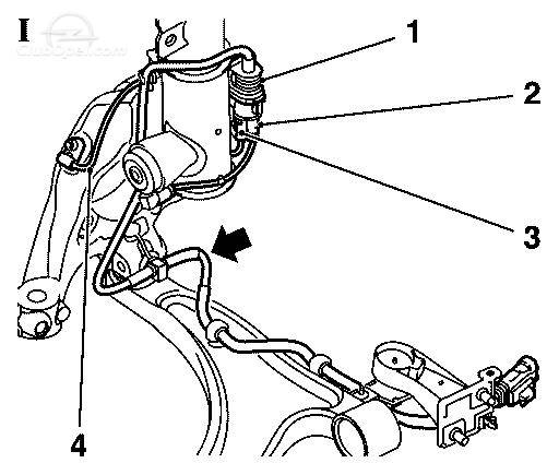

1. Check continuously variable real time damping wiring harness for
broken cable (Picture I, arrow)
Note:
No external cracks will be visible.
- Measure wiring harness resistance while moving the harness back
and forward in shown area (Picture I, arrow)
Note:
If a cable is broken inside the continuously variable real time
damping wiring harnesses replace the wiring harness by the NEW
improved version on both sides.

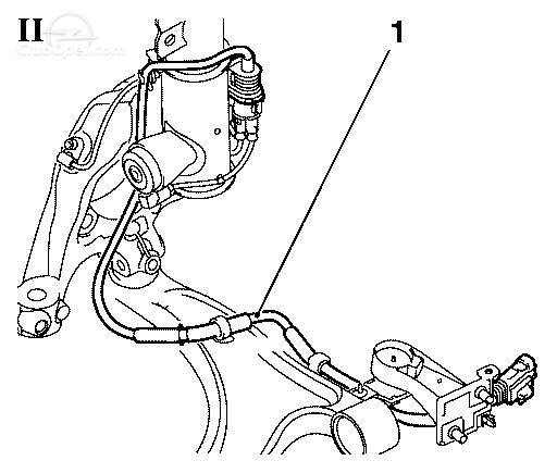

2. Replace continuously variable real time damping wiring harness
(Picture II, 1)
Important:
If the replacement of the continuously variable real time damping
wiring harness is required, pay attention to the NEW routing, as
shown in picture II!
3. Check continuously variable real time damping wiring harness plug
for corrosion (Picture I)
- Continuously variable real time damping wiring harness plug (1)
- Wiring harness plug CDC valve (2)
- Wiring harness plug CDC sensor (3)
- Wiring harness plug ABS sensor (4)
Note:
Replace corroded component on both sides.

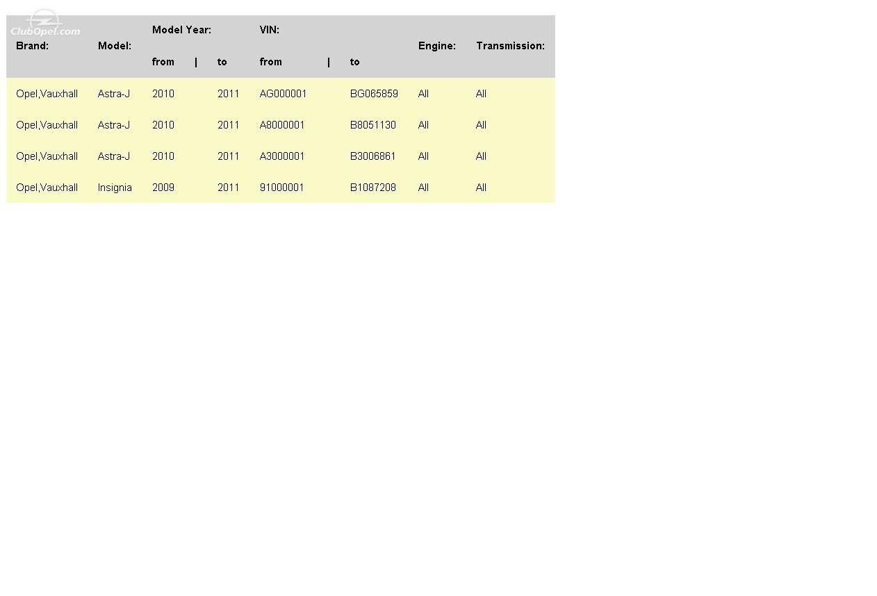

Lucio, te rog poți sa confirmi dacã motorul A14NET cu VIN ...BG0244xx se încadreazã in campania asta si ce ar trebui sa fac?
  • lucio85
  • Mesaje scrise: 4,964
  • Locatie: Gorj
  • Masina: Astra 2010 a17dtr
cum se vede si din poza si cum am si scris mai sus nu conteaza motorizarea si transmisia e vorba de lot de masini cuprins intre niste serii
BG0244xx este mai mica decat BG065859 asa ca se incadreaza, daca iti apare problema mai sus mentionata mergi la service

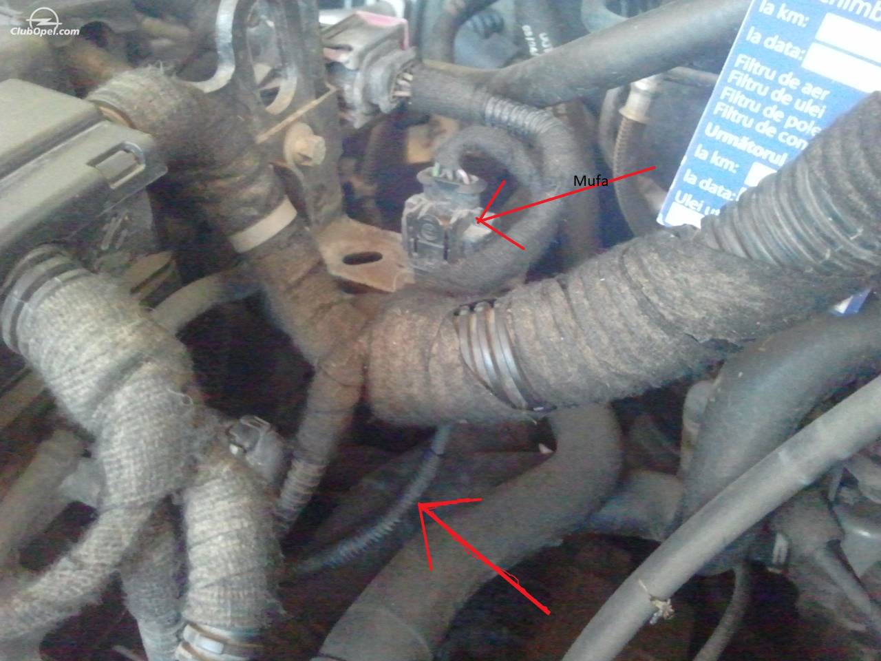

Problema s-a rezolvat. din intamplare am atins firul care duce de la mufa la senzorul de la vibrochen si s-a oprit motorul. deci acolo era problema. contact imperfect. am scos si am bagat la loc mufa de cateva ori si acum nu mai face.
