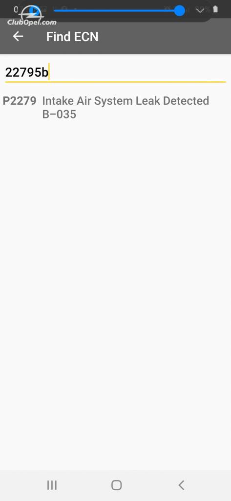

  • Mr.Opel
  • Mesaje scrise: 2,471
Adaug la lista garnitura de la throttle body, daca are asa ceva:
