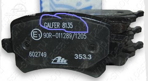

Si inca o chestie, apropo de ATE. Daca vreti ATE, luati ATE, nu Galfer by ATE.
