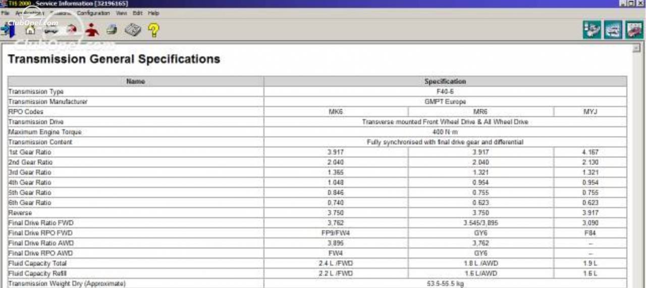

https://workshop-manuals.com...x_specifications/
Ai MYJ tip cutie
MYJ = MANUAL TRANSMISSION,6 SPEED,F40 TYPE
Se baga ulei GM 19 40 182.
Poza era pe forum!
Golesti tot si bagi 1.6 litri
