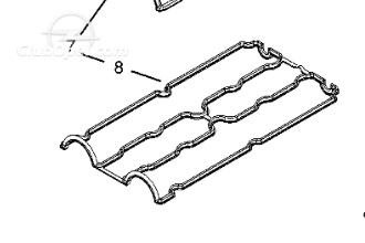

Schimbã garnitura de la axele cu came este o garniturã dintr-o singurã bucatã
  • Mesaje scrise: 7,409
Asta e ce ai nevoie:
8 638 742 90573498 -GASKET,CYLINDER HEAD COVER cu echivalente
Gasket, cylinder head cover 11081000 AJUSA
Gasket, cylinder head cover 127.580 ELRING
Gasket, cylinder head cover 1542617 ELWIS ROYAL
Gasket, cylinder head cover 206 133 TOPRAN
Gasket, cylinder head cover 3006380742 AUTOMEGA
Gasket, cylinder head cover 40 92 8630 SWAG
Gasket, cylinder head cover 440075P CORTECO
Gasket, cylinder head cover 50-029202-00 GOETZE
Gasket, cylinder head cover 515-5091 TRISCAN
Gasket, cylinder head cover 53916 GLASER
Gasket, cylinder head cover 638 742 OPEL
Gasket, cylinder head cover 71-34288-00 VICTOR REINZ

Schimbã garnitura de la capac 638 742 OPEL
