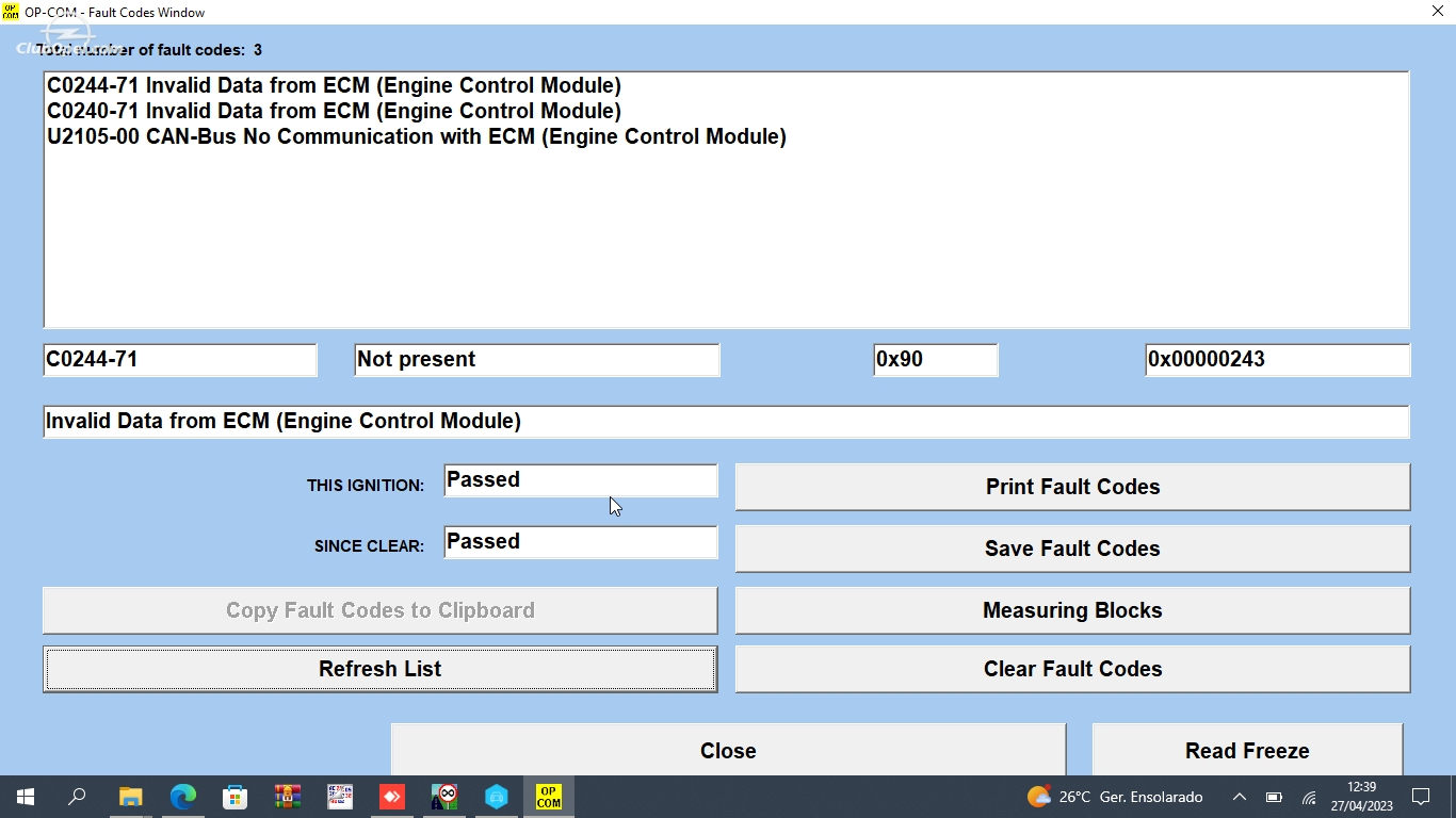

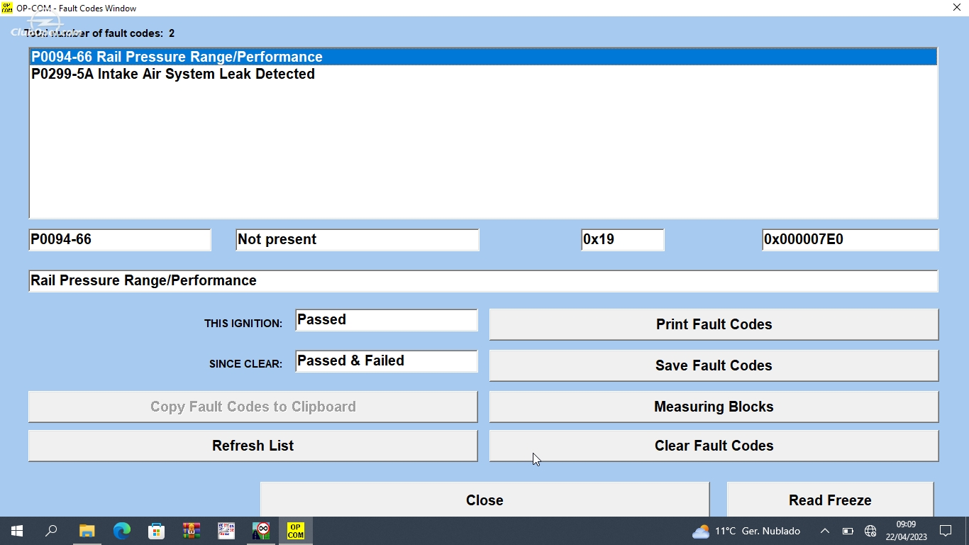

dtc..
engine ecm p0094 66 rail pressure range/perfomance
abs
c0244 71 invalid data from ecm
c0240 71 invalid data from ecm
u2105 00 can bus no communication with ecm

In the Astra H, equipped with this engine, the first suspect in such unpredictable behaviors is a flooded ECU.
Equally well known is the problem that occurs in the plug of the fuel flow regulator (SCV), located on the high pressure pump.
Also, a log should be made with the fuel pressure values, in the moments when there are problems.
Let's not forget the regulators (SCV) which are also problematic.
