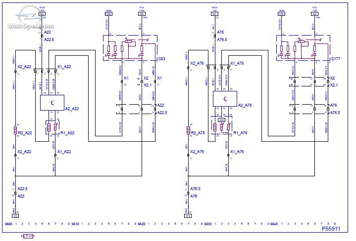

ARE CINEVA SCHEMA ELECTRICA A CIRCUITULUI DE INCALZIRE SCAUN!

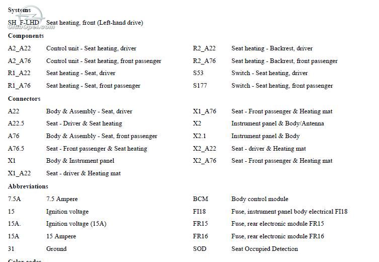

Schema
