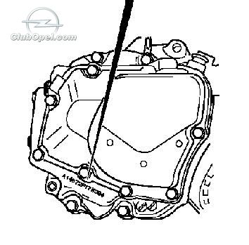

auzind mai multe pareri m-am decis sa-mi cumpar o cutie de viteza ( second) dar is nedumerit cu o chestie .
Eu am Opel astra G Bertone , 1.8 , benzina , 16v , Z18XE .
Cutia care am cumparat-o provine de la o Opel Vectra B2 din 2001,motor Z18XE , euro 4, 1.8 benzina , 16v ( motorul identic )
Intrebarea : Stie cineva sigur sigur daca se potriveste pe masina mea? 😃 tinand cont ca am luat-o la un pret destul de bun zic eu ( 150 E )

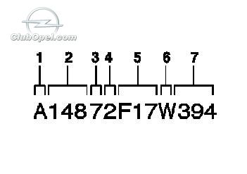

1. Manufacturing plant (A = Aspern, B = Bochum)
2. Day in year
3. Last digit of year
4. Work shift (1 = early shift, 2 = late shift)
5. Transmission type (F13/F13+, F17/F17+)
6. Transmission code: W = Wide Ratio, C = Close Ratio
7. Final drive ratio
