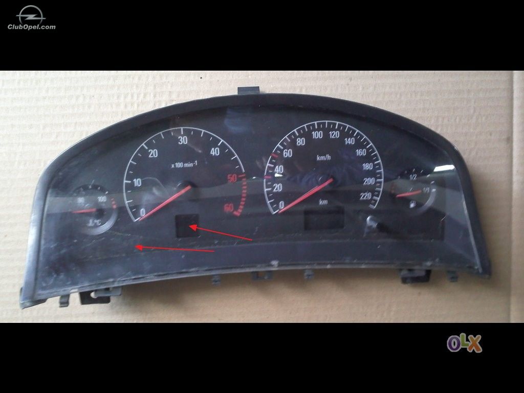

Hi i have changed my instrumente painel but now i have this massage and it is not working ok what do i have to do
3925 - Wrong Environment Identifier Received IPC (Instrument)
(00) - Present
U2102 - CAN-Bus (Low Speed) Maximum Configuration List Not Programmed
(0F) - Present
B2991 - Passenger Door Switch Circuit Open or High Voltage
(05) - Present
TPMs sinilzion is also presente
Thank´s
  • Mesaje scrise: 7,022
You have to reset and program IPC instrument. You`ll need both security codes.
Check and reconfigure Can Bus (Low Speed) List.
Check passenger door conector-switch.

When i try to force the signal with opcom like belt insert work fine , like odmetor miles , but if i dont bukle my belt sign wont came one ony the belt and the TPMS is apearing...... is it better look for another instrument painel?
Thank´s
No, find somebody who can read the IPC security code from IPC`s EEPROM. Then reset it and reprogramm it.

I don´t now how but they changed:
the airbag informacion don´t now how ( light comes on and go OFF)
B0021 - Passenger Side Airbag Squib Circuit High Resistance(0D) - Present
B0023 - Passenger Curtain Airbag Squib Circuit High Resistance(0D) - Present
the motor informacion wasen´t working
the velocity was not corrected.
