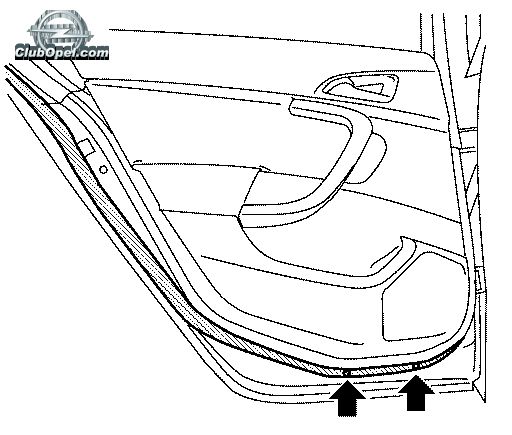

Door Sill - Water Accumulation
Vehicles:
Insignia 2009-Onwards
Insignia Sports Tourer 2009-Onwards
All Engines
Complaint:
Water accumulates in sill area of front and rear doors.
Cause:
Poor fit of sealing clips allows water entry.
Production
Modified weatherstrip in production as of VIN WOLGM67C191115427.
Remedy:
In case of customer complaint apply additional drain holes (diameter 5 mm) into weatherstrip
Check in door below window glass if the weatherstrip clips are tight. If the weatherstrip clips are loose or can be pulled out easily, replace the clips.
