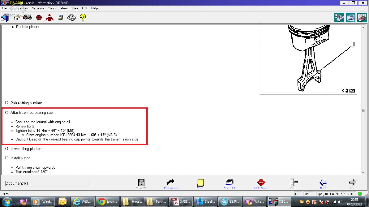

Din TIS citire:
6. Install con-rod bearing cap
Important: Bulge (arrow) on the con-rod bearing cap points towards the transmission side.
• Lay Plastigage over the width of the con-rod journal
• Tighten 2x bolt 10 Nm + 60° + 15° (M6)
– From engine number 19P13554 13 Nm + 60° + 15° (M6.5)
Note: Bolts do not need to be renewed for measuring the con-rod bearing clearance. Do not turn crankshaft.
Deci, functie de motor avem suruburi M6 si M6.5, cu strangeri corespunzatoare:
- cuplu 10Nm + 60grd +15 grd.
- cuplu 13 Nm + 60grd + 15 grd.

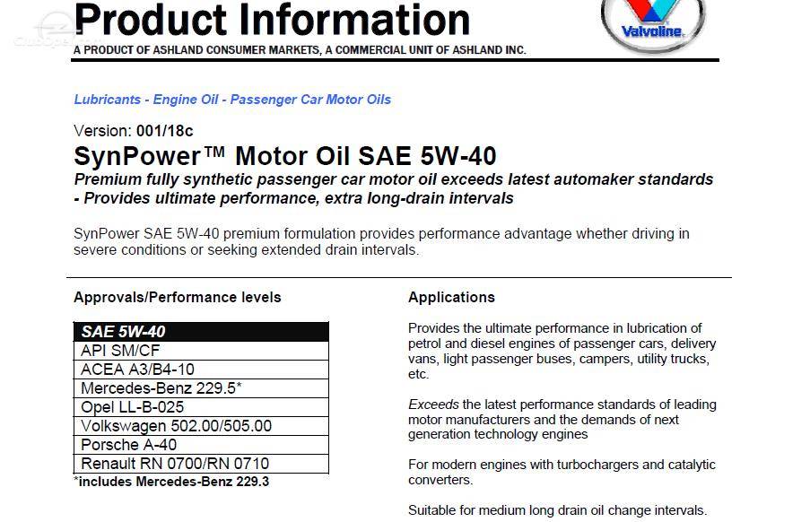

Aralul este uleiul care umple motoarele de sludge cel mai mult DE EX in Germania au inchis gura multor service-uri cu discounturi mari la reclamatiile serviciilor tehnice.
mergi pe cai batatorite
VALVOLINE,MOBIL1, ENEOS,MOTOREX,COMMA, FUCHS, MOTUL, RAVENOL,
N-am auzit in ultimele doua decenii vre-un motor distrus sub 400000km uns cu VALVOLINE sau MOBIL1 autentice. cu norma motorului,schimbat la maxim 10000km

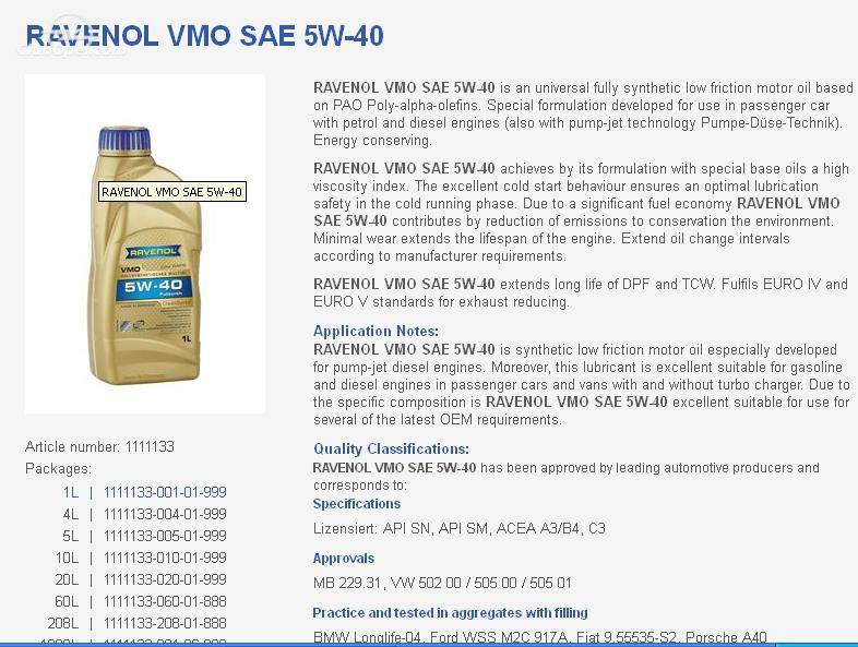

Cat despre RAVENOL
RAVENOL LSG 5W-30 indeplineste si chiar depaseste urmatoarele norme si standarde:
ACEA A3/B4, ACEA A5/B5
API (*gelistet) SM/CF*
OPELOpel GM-LL-A-025 (B-040-2095)/-B-025 (B-040-2098), dexos2 (License No. GB2C0602081)
SAE 5W-30
