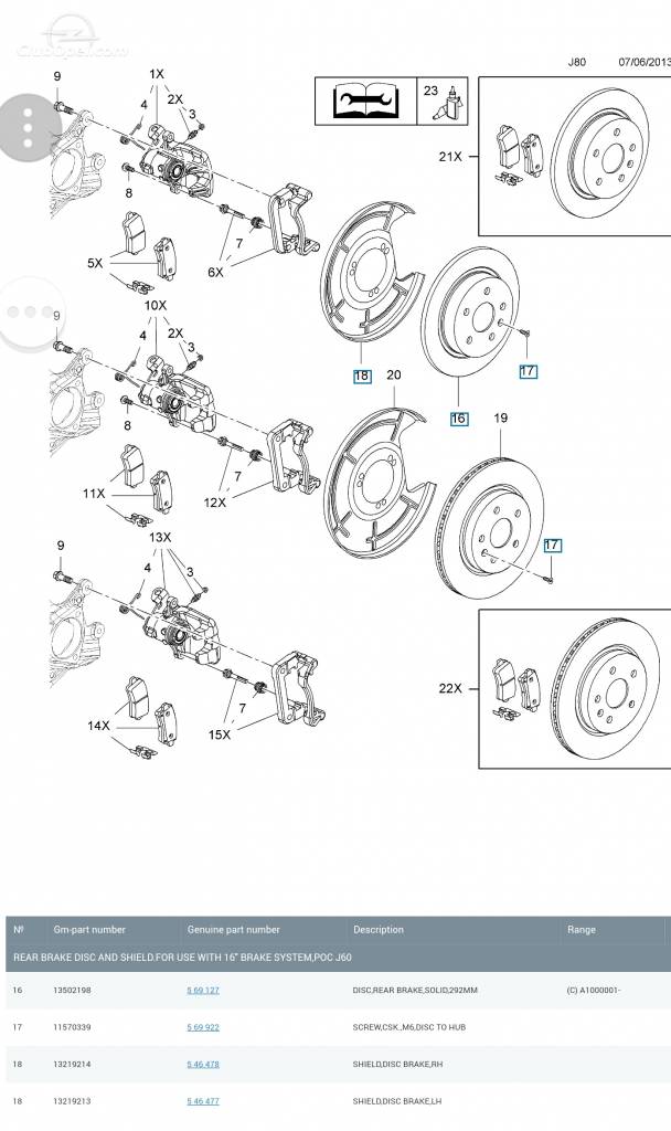

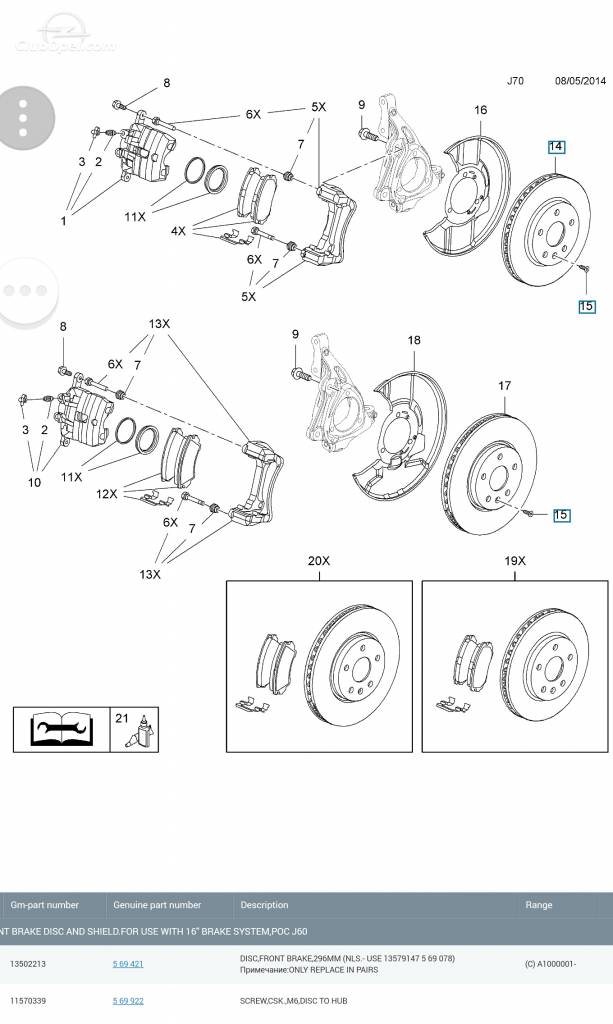

Salut am o nelamurire cu dimensiunile ce trebuie sa le cumpar pt discuri fata spate. am verificat ce scrie in VIN despre sistemul de franare si din ce am vazut am gasit doar asta : J60=FOR USE WITH 16" BRAKE SYSTEMJ71. problema e ca eu am jante pe 17. e un opel insignia 2013 96 kw diesel automata. . acesta este vin : W0LGM8GLXD1128553.
asta e tot ce scrie in decodarea VIN: VIN:W0LGM8GLXD1128553Model:INSIGNIABody type:5-door wagon / estateMade:2013-07-02Model for year:2013Made for:Germany (steering wheel on the left)Factory:Russelsheim, GermanyEngine:A20DT (diesel, 2.0 CDTI, 130 HP, DPF installed)Colour:Sovereign Silver, paint code: GANEngine number:17B40523Serial number:1285531st registr. No.:SU-AL 326Source:http://astra-3.pl/vin.php
Code=Description***General information:***AXJ=VEHICLE TYPE, PASSENGER CARCT3=FOR GERMANYGAN=EXTERIOR PAINT,SEE MODEL CATALOGUE FOREWORD PAINT CHARTGM=EQUIPMENT LEVEL: EDITION / ELEGANCE / EXCLUSIVMAE=FOR EUROPENC0=EQUIPMENT,EUROPEAN UNIONOGA=WITH OPEL SPECIAL VEHICLEV83=VEHICLE STATEMENT - ECE ORGANIZATIONVRH=OPEL / VAUXHALL SPECIFICATION - STEERING COLUMNWRB=WIRING PROVISIONS CUSTOM WIRING HARNESS (INSTRUMENT PANEL)XL8=FOR 433 MHZ FREQUENCY***Drive (engine, transmission):***FHY=VEHICLE FUEL DIESEL B10K13=USED WITH EXHAUST SYSTEM PARTICLE FILTERLBR=A20DT[LBR] DIESEL ENGINEMDK=AF40-6 AUTOMATIC TRANSMISSIONMM1=USED WITH AUTOMATIC TRANSMISSIONNE9=EMISSION SYSTEM EEC 09***Suspension and wheels:***6Y4=SPARE WHEEL AND TYRE,DELETEGNA=CHASSIS EQUIPMENT, FRONT STRUT ASSEMBLYGNC=CHASSIS EQUIPMENT, REAR AXLE, 4-LINKQNR=TYRE ALL 225/55R17-97WQR8=WHEEL 17X7, STEEL, DELUXEVRL=OPEL / VAUXHALL SPECIFICATION - FRONT HORIZONTIAL SUSPENSIONVRM=OPEL / VAUXHALL SPECIFICATION - FRONT VERTICAL SUSPENSIONVRN=OPEL / VAUXHALL SPECIFICATION - REAR SUSPENSIONVRR=OPEL / VAUXHALL SPECIFICATION - TYRES AND WHEELSWTR=TEMPORARY TYRE REPAIR***Glass and mirrors:***AEF=POWER WINDOWS, EXPRESS UP/DOWNAER=ELECTRICALLY OPERATED WINDOWS,REARAKN=GLASS,TINTEDAKW=WINDSCREEN,TINTEDAXG=FOR ONE TOUCH WINDOWDD8=FOR LIGHT SENSITIVE INTERIOR MIRRORDH6=VISOR,SUN,WITH ILLUMINATED MIRROR,RH-LHDP6=MIRROR HOUSING, PAINTEDDWE=USED WITH MANUAL FOLDING MIRROR***Lighting:***CE4=HEADLAMP WASHERT3U=FRONT FOGLAMPT4F=HEADLAMPS,XENONT61=FOR DAYTIME RUNNING LAMP SYSTEMT79=FOR REAR FOGLAMPST95=DIRECTIONAL HEADLAMPS (ADAPTIVE FORWARD LIGHTING)TQ5=FOR INTELLIGENT HIGH BEAMTR7=HEADLAMP LEVELLING,AUTOMATICTSP=LAMP,ASSY,INTERIOR CUSTOMTSQ=LAMP INTERIOR DELUXETTW=FOR AUTOMATIC HEADLAMPS WITH TUNNEL DETECTION***Bodycar:***B9K=PLATE DOOR SILL COVERMDE=FOR CHROME WINDOW SURROUND MOULDINGV3E=LUGGAGE CARRIER CLEAR ROOF,SILVERVG2=PROTECTION WAX,DELETEVK0=TRAILER HITCH HOOK,SWIVEL TYPE,MANUAL***Interior:***01A=BLACK SEAT TRIM1AB=TRIM COLOUR DOOR PANEL BLACK2A0=MOULDING DOOR INTERIOR, GRAINED ANTHRACITE3A0=RAPID COOL GREY MOULDING4AA=BLACK INTERIOR TRIMDK6=INTERIOR ROOF CONSOLEDT4=ASHTRAY AND CIGARETTE LIGHTER (SMOKERS PACK)EAC=TRIM SEAT CLOTH, DUNEFBD=ATLANTIS CLOTH DOOR TRIMKD4=USED WITH FRONT CONSOLE ELECTRICAL RECEPTICLEKPA=USED WITH FRONT CONSOLE ELECTRICAL RECEPTICLELHD=LEFT HAND DRIVEN34=WHEEL,ASSY.,STEERING,THREE SPOKES,LEATHERU18=SPEEDOMETER,ASSY.,K.P.HVRG=OPEL / VAUXHALL SPECIFICATION - COCKPITVRK=OPEL / VAUXHALL SPECIFICATION - ROOF TRIM***Safety:***A69=RESTRAINT SEAT BELT TENSIONER, FRTA70=LOCK, SEAT BELT WITH TENSIONERAJF=HEAD RESTRAINT,FRONT SEAT,ACTIVEAJT=FOR SAFETY NET INSTALLATION PROVISIONSATG=LOCK CONTROL REMOTE ENTRYAW7=FOR REAR SIDE AIRBAGSC99=PASSENGER AIRBAG DISABLE SWITCHFX3=ELECTRONIC STABILITY PROGRAMG=ACTIVE MANUAL BELTS, AIRBAGS FOR DRIVER AND PASSENGER FRONT, FRONT AND REAR SEAT SIDE, ROOF SIDEJ60=FOR USE WITH 16" BRAKE SYSTEMJ71=ELECTRIC PARK BRAKEUD5=UH1=SEAT BELT WARNING,RHUH5=SEAT BELT WARNING,REAR***Multimedia:***KRJ=FOR AUDIO MULTIFUNCTION CONTROLMCR=RECEPTACLE MEMORY CARDU65=SPEAKER,7UCW=RADIO NAVI 900UDC=FOR MONOCHROMATIC DOT MATRIX DRIVER INFORMATION CENTREUDK=GRAPHIC INFO - COLOURUPH=WITH WIRELESS INTERFACE,SHORT RANGE,VOICE RECUS3=ANTENNA DIVERSITYUSR=FOR USB PORTW1Y=FOR STEERING WHEEL RADIO OPERATIONWGC=EQUIPMENT RECEIVING UNIT,GPS***Heating and air conditioning:***C59=NOZZLE,REAR AIR VENTC68=FOR ELECTRONIC AIR CONDITIONINGKA1=FOR HEATED FRONT SEATSUVD=SWITCH STEERING WHEEL,HEATED***Equipment and comfort:***A51=FRONT BUCKET SEATA6A=FOR SEAT WITH PARTIALLY MANUAL 4-WAY ADJUSTABLE GUIDE RAILAG5=FRONT SEAT,RH,HEIGHT ADJUSTER,MANUALAPG=FOR 4 WAY POWERED LUMBAR SUPPORTAY5=HEAD RESTRAINT,REAR,CLOTH,CENTERCE1=WIPER,FRONT,PULSE SYSTEMDA1=ARMREST REAR SEAT,STORAGEEA1=POCKET,FRONT SEAT BACK,LHEA2=POCKET,FRONT SEAT BACK,RHK34=CRUISE CONTROLN37=STEERING COLUMN, ADJUSTABLE, REACH AND RAKENJ1=POWER STEERING, NON-VARIABLE RATIO, ELECTRIC STANDARD RACK TRAVEL***Electrical system:***K09=ALTERNATOR,120AMPK3S=BATTERY,75AH

Salut, am exact sistem j60 și eu și le-am schimbat anul trecut pe spate. Am pus TRW de 292 mm. Pe fațã anul ãsta am pus tot TRW de 296 MM, plãcute desigur TRW. Sunt ok, nu am probleme cu ele. Dar sã fii atent la montaj sã ți ia plãcuțele la polizor cum trebuie. Sã nu le batã fix in locaș cã nu se vor retrage și vor rãmâne blocate pe disc. Am pãțit-o de douã ori , ultima oarã cu discul nou pe spate. Mi-a înroșit discul și i-a fãcut șanțuri. Dobitocul de mecanic nu a dimensionat bine o plãcuțã și nu se retrãgea de pe disc, roatã mergând înfrânatã.
Eu am jante pe 18, dar nu au intrat in standard ci la opționale. De asta am sistem j60. La fel și tu.
Dupã schimbarea plãcuțelor sã verifici roțile din când în când sa nu fie vreuna mai încinsa și sã le mai asculți in mers sã nu frece pe disc.

Ai sistem frânare POC J61(17”):
-disc fațã 321mm GM 13502214;
-plãcuțe frânã fațã GM 95514526 (sau GDB1783/TRW, 40 91 6892/SWAG, 0 986 494 609/Bosch, LP2081/Delphi, P 59 055/Brembo);
-plãcuțe frânã spate GM 95515498(sau 2442102/Textar, 40 11 6147/SWAG, 8DB 355 012-991/Hella, LP2084/Delphi, P 59 060/Brembo);
-kit disc(315mm)+plãcuțe spate GM 95516092.

Din decodare zice ca ai POC J60, cel pe 16". 😊
ATE sunt foarte bune.
