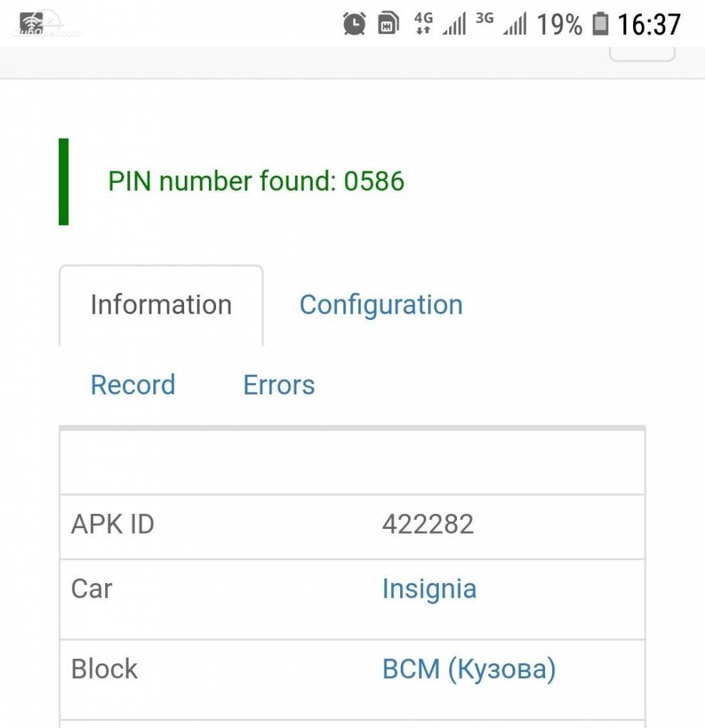

Pt Caras Severin ofer car pass pt insignia
