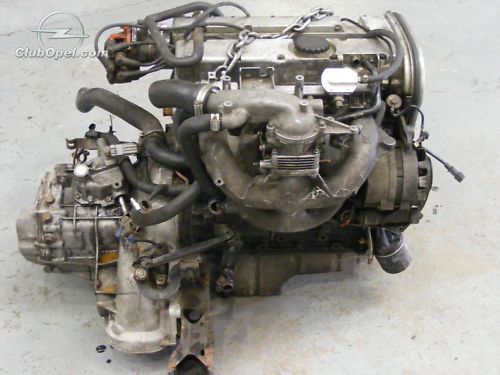

CALIBRA 2.0 ENGINE AND GEARBOX. THE ENGINE HAS BEEN DYNOD AT 300BHP.
THE ENGINE IS FITTED WITH A NEW STAGE 1 TURBO THAT HAS DONE LESS THAN A 100MILES
IT HAS A NEW 360 DEGREE THRUST BEARING, NEW HEAVY DUTY CLUTCH AND A BRAND NEW QUAFE LIMITED SLIP DIFF THAT HAS DONE LESS THAN 50 MILES.
motorul e la vanzare,daca te intereseaza
