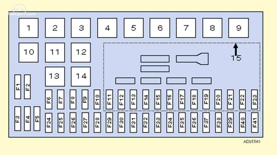

Astra G | X16SZR , X16XEL , Z16SE, Z16XE | 1998-2000
https://translate.google.com/#en/ro/

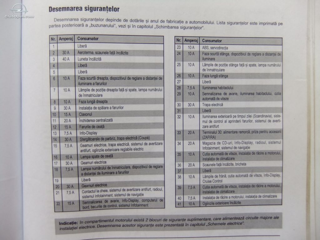

Fuse (Amps) - Circuit
F1 - (Libera)
F2 (30A) - Heater/air conditioning (AC), heated seats
F3 (40A) - Heated rear window
F4 - (Liber)
F5 - (Liber)
F6 (10A) - RH headlamp - low beam, headlamp adjustment
F7 (10A) - RH side/tail lamps, licence plate lamp
F8 (10A) - RH headlamp - high beam
F9 (30A) - Headlamp washer pump
F10 (15A) - Horn
F11 (20A) - Central locking
F12 (15A) - Front fog lamps
F13 (7,5A) - Digital multifunction display
F14 (30A) - Windscreen wiper motor
F15 (7,5A) - Electric windows, sunroof, electric door mirrors
F16 (10A) - Rear fog lamp
F17 (30A) - Electric windows
F18 (7,5A) - Headlamp adjustment
F19 - (Liber)
F20 (30A) - Electric windows
F21 (7,5A) - Ignition switch key hold solenoid (AT), alarm system, audio system
F22 (15A) - Indicators/hazard warning lamps, digital multifunction display, trip computer, warning lamps
F23 (10A) - Anti-lock brake system (ABS), power steering
F24 (10A) - LH headlamp - low beam, headlamp adjustment
F25 (10A) - LH side/tail lamps, licence plate lamp
F26 (10A) - LH headlamp - high beam
F27 - (Liber)
F28 (7,5A) - Interior lamp
F29 (10A) - Indicators/hazard warning lamps, interior lamp
F30 (30A) - Sunroof
F31 - (Liber)
F32 (10A) - Daytime running lamps, alarm system
F33 (20A) - Trailer socket - terminal 30
F34 (20A) - Audio system, digital multifunction display
F35 (10A) - Automatic transmission (AT), engine coolant blower motor control module, air conditioning (AC)
F36 (20A) - Heated seats, cigarette lighter
F37 - (Liber)
F38 (10A) - Stop lamps, automatic transmission (AT), digital multifunction display, cruise control
F39 (7,5A) - Automatic transmission (AT), engine coolant blower motor control module, air conditioning (AC)
F40 (7,5A) - Engine coolant blower motor control module, air conditioning (AC)
F41 (10A) - Heated door mirror
Relee din tablou.
1 - (Liber)
2 Horn relay
3 Headlamp high beam relay
4 Rear screen wiper relay
5 Door mirror heater relay
6 Fog lamps relay
7 Rear fog lamp relay
8 Indicator relay - RH
9 Indicator relay - LH
10 Telephone audio signal transmitter
11 - (Liber)
12 Windscreen wiper motor relay
13 - (Liber)
14 Heated rear window relay
15 Multifunction control module

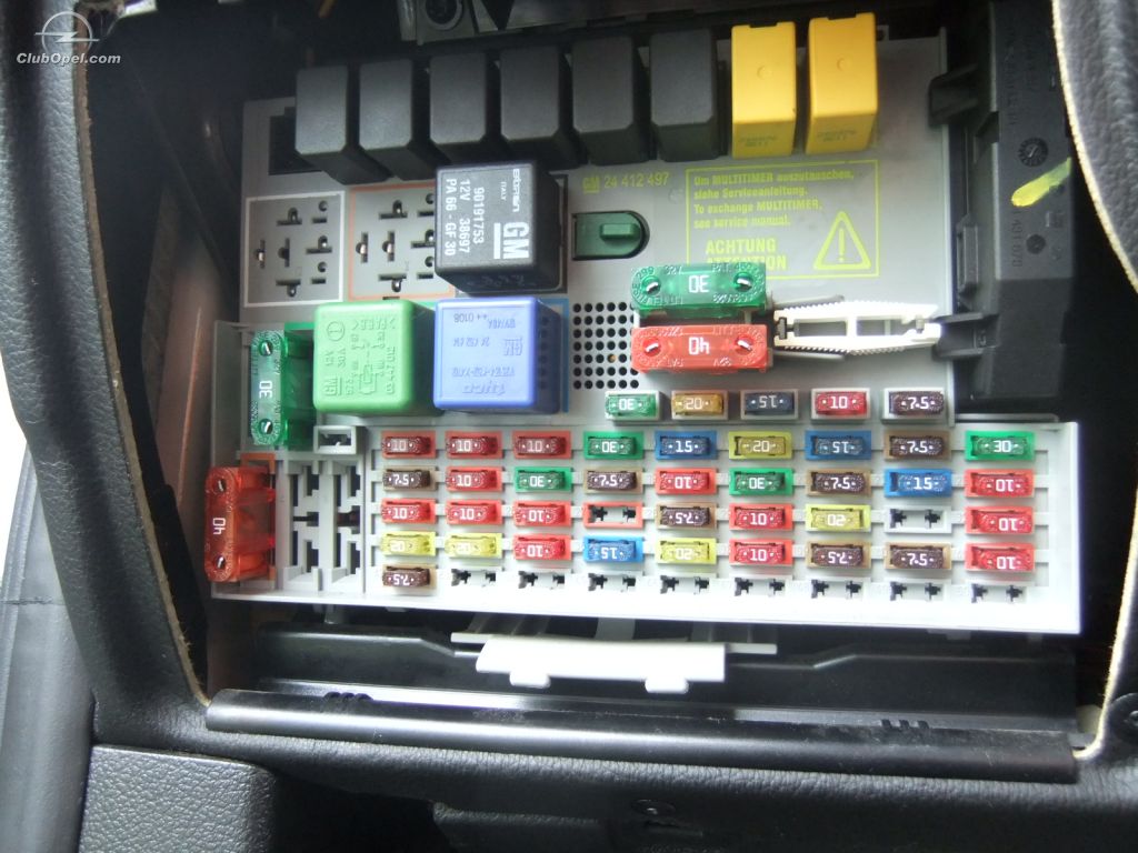

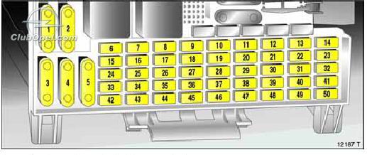

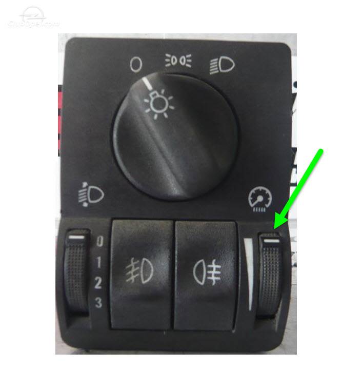

Salutare ! De curand sunt posesorul acestui model, insa nu afiseaza display-ul mic de pe mijloc ( nu se aprinde deloc, e negru ). Am citit pe aici ca ar fi de la sigurante. Daca lipseste siguranta din tablou, va rog sa imi spuneti in care locas din acelea o pun 😊
https://s7.postimg.org/4ooe6..._2005248859_n.jpg

este vorba de cel de pe mijlocul bordului. Nu cel de la vitezometru si turometru 😊

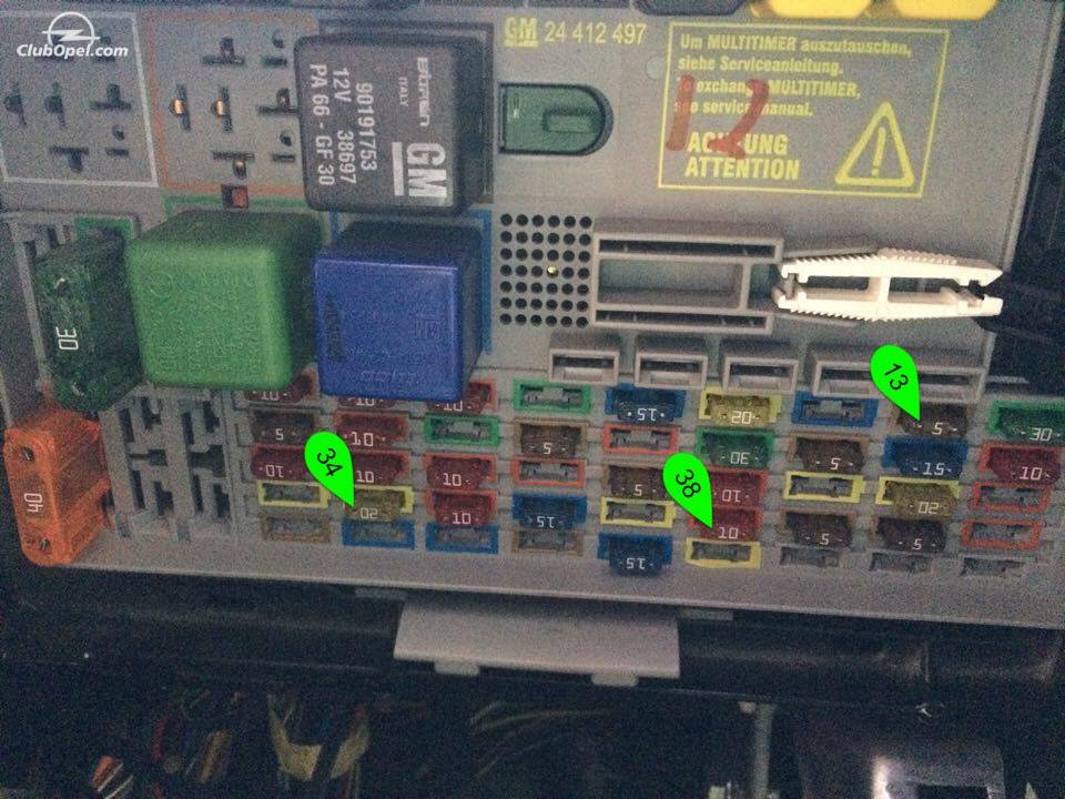

Pentru info-Display sunt sigurantele 13, 34, 38.
Vezi butonul de reglare a intensitati luminilor din bord + info-Display |- sa fie in sus sau cat iti place.
Am patit-o odata la drum lung.
La tine vad ca lipseste siguranta 41 - Oglinzile exterioare incalzite

Da, stiu de reglarea luminii din butonul ala, dar el nu se aprinde deloc, si cu oglinda nici n-am observat daca se dezabureste, nici nu stiu care e butonul pt dezaburire oglinda 😢

La mine butonul a fost jos si nu se vedea nimic pe display - vezi si tu.
Sau are mufa oxidata.
Verifica si cele 3 sigurante sa nu fie una arsa.
"nici nu stiu care e butonul pt dezaburire oglinda" - este cel care dezabureste si luneta.

care cele 3 sigurante ? care sunt din poza care am pus-o eu !

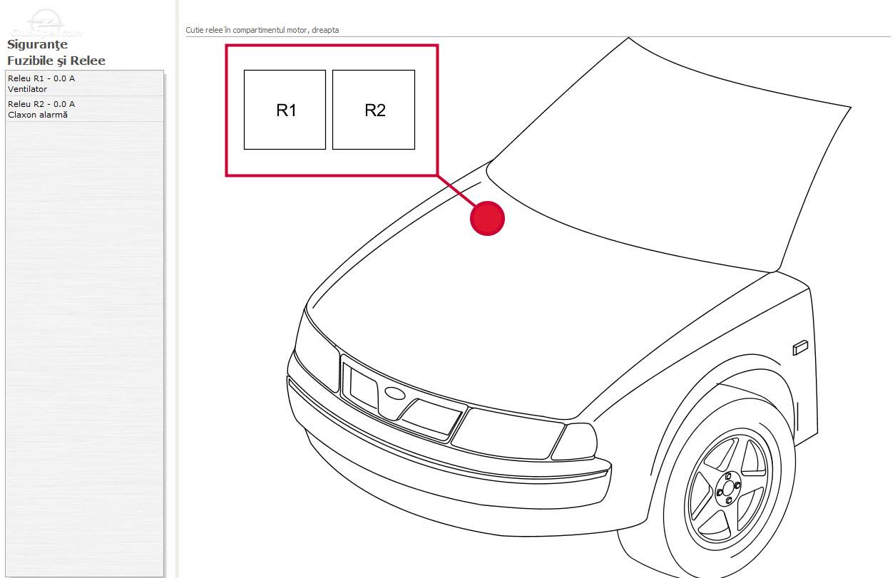

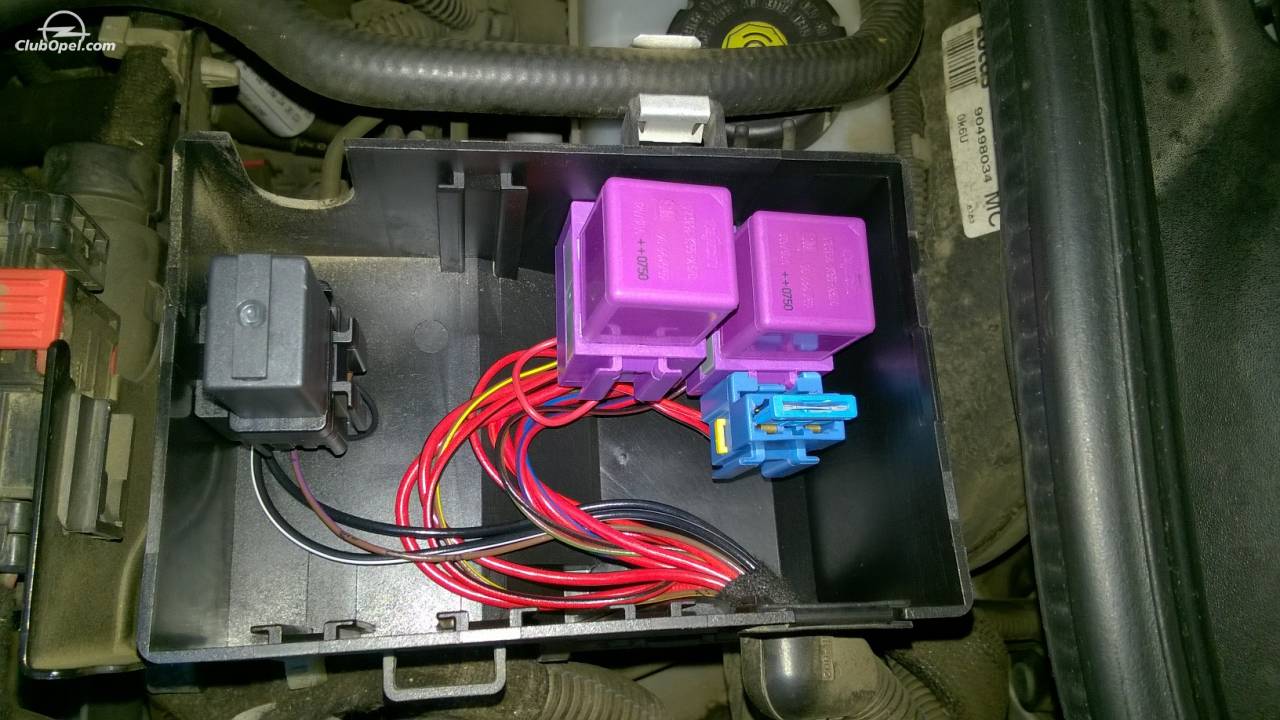

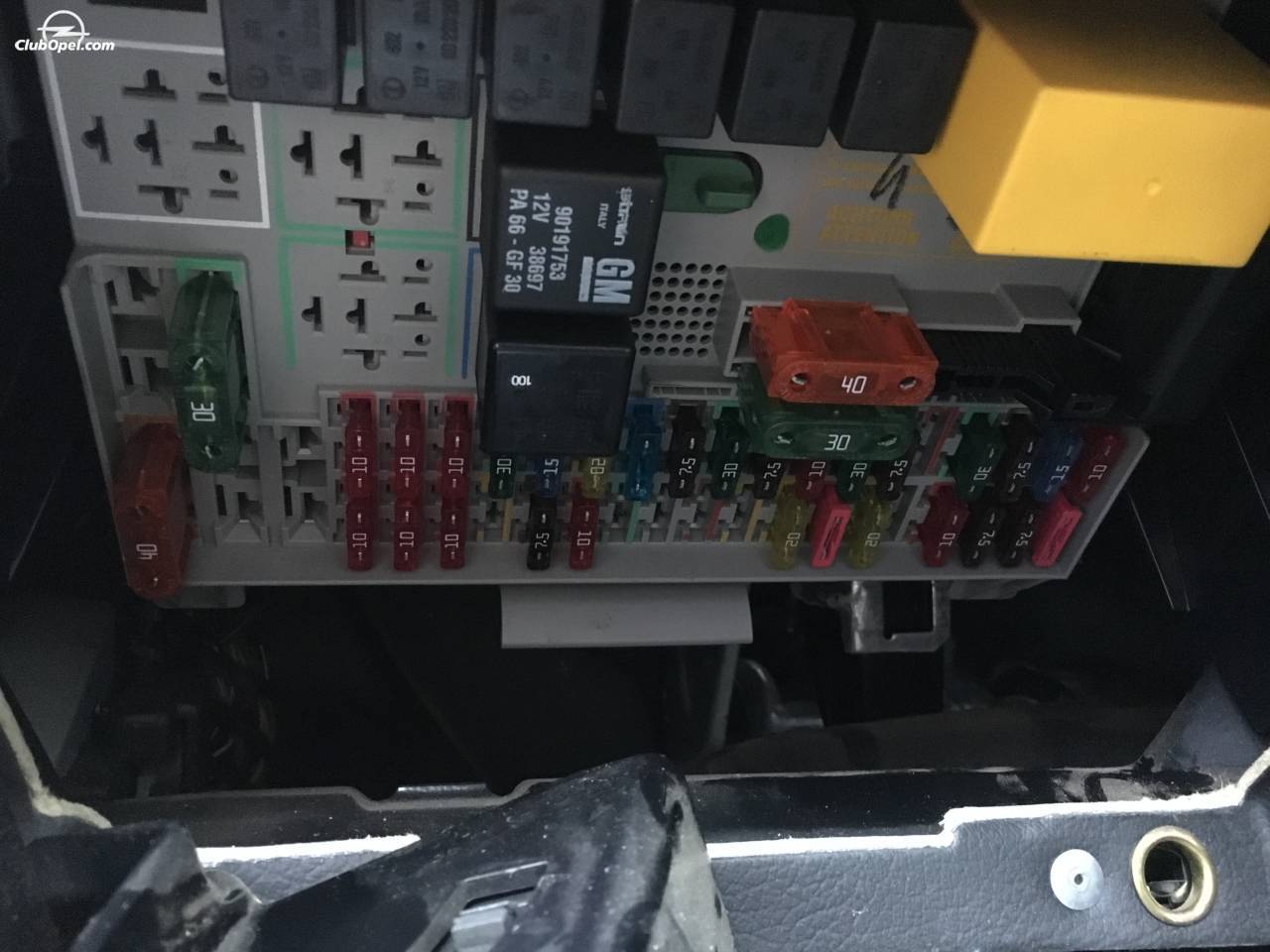

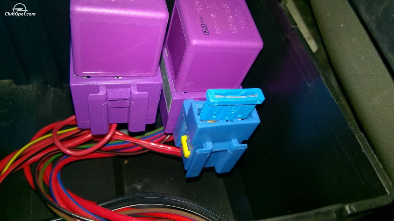

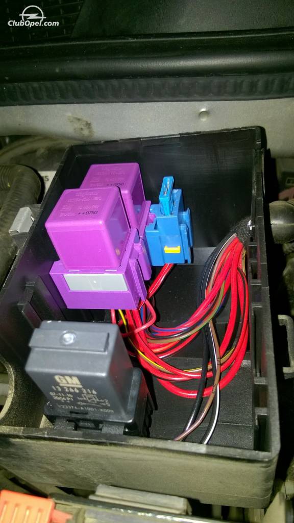

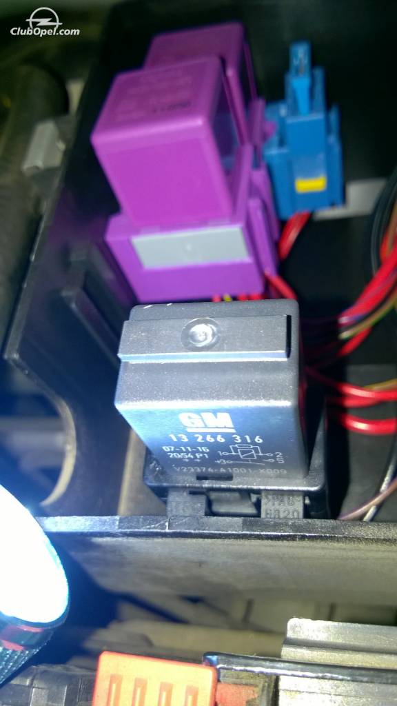

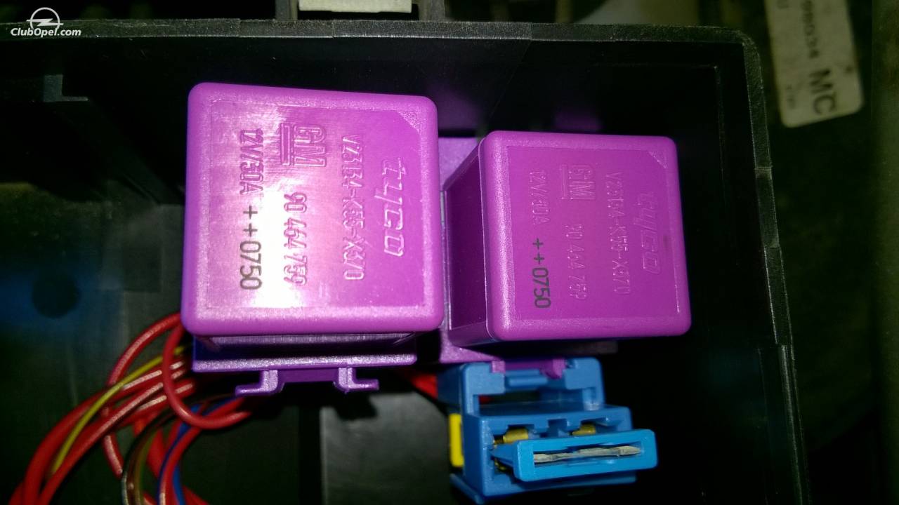

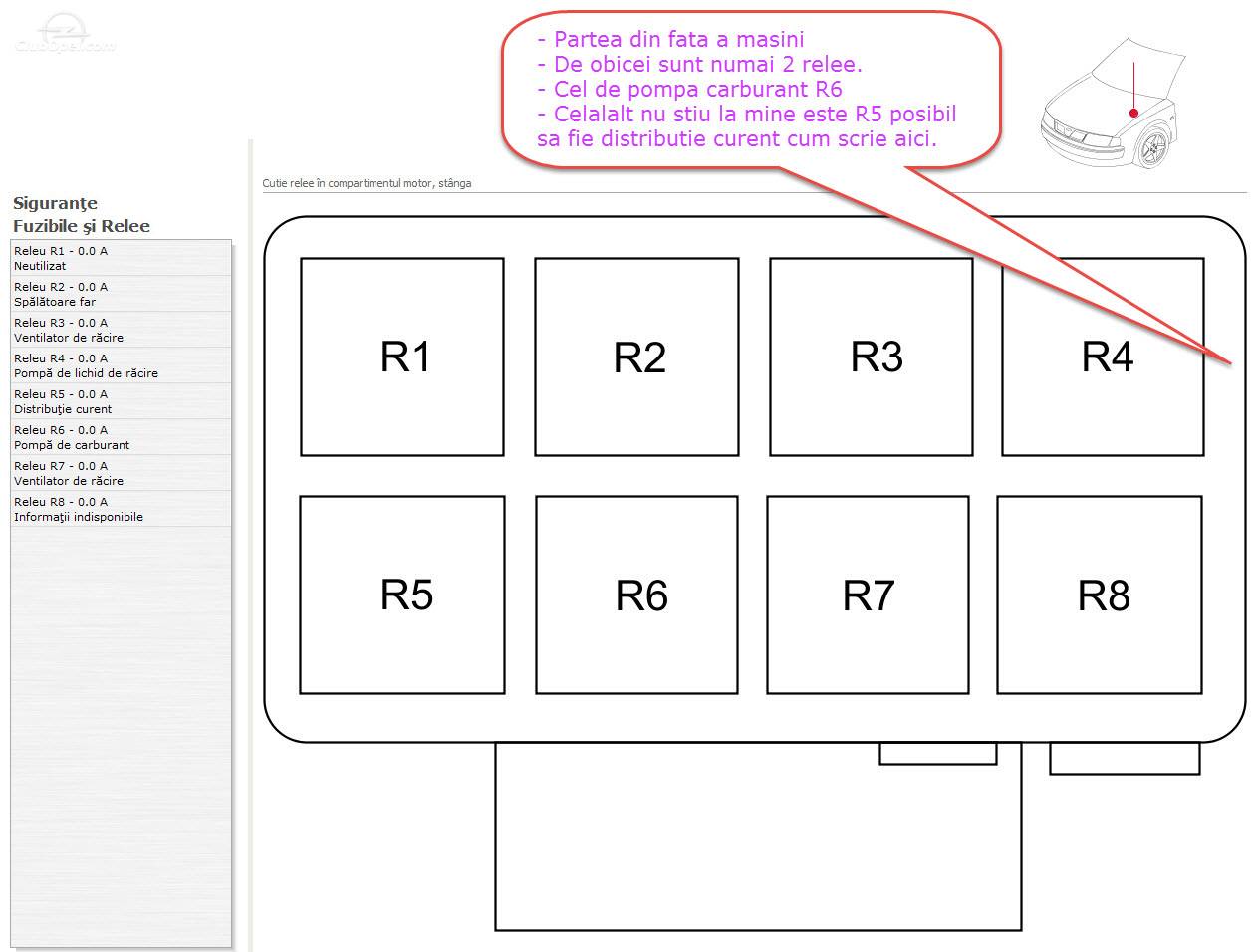

Masina este un Astra Classic II din 2008, motor Z14XEP. Atasez 5 poze cu cutia releelor din compartimentul motor.
Poate sa-mi spuna cineva ce rol au aceste relee si siguranta aferenta (sunt 2 relee identice mov cu o siguranta langa ele si un releu negru)? Codurile se vad in poze.
Mentionez ca am tot cautat pe net despre aceste relee dar nu am gasit mai nimic. Am o banuiala ca unul din releele mov e pentru alimentarea cu combustibil, dar de ce sunt doua identice?
Ma intereseaza aceste relee fiindca vreau sa-mi fac un soi de kill switch pe releul sau siguranta pompei de combustibil ca sa nu se poata porni masina. Acelasi lucru l-a intrebat un coleg mai sus, am mai pus intrebarea pe un alt topic (cel cu protejarea masinii impotriva hotilor) dar nu am primit nici acolo raspuns. Nu vreau sa fac chestia asta zi de zi, dar au fost cazuri cand am lasat masina in niste parcari atat de dubioase, ca ma gandeam ca a doua zi voi gasi in locul masinii doar sigla lasata de amintire 😢
Multumesc.
