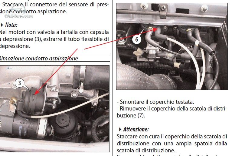

hi i have a problem in the Swirl Level Control Solenoid Valve Pulse where is it located? and what can i do

For the second code check the F 15 fuse from the engine bay. If its ok, look at the swirl actuator (back of the radiator), see if it works.

it was the conector since i have only one Swirl Level Control Solenoid Valve .
is this a read only valve or a control valve.
can someone explain becau-se now it is in 4% and i dont see it moving.
Thank´s again
