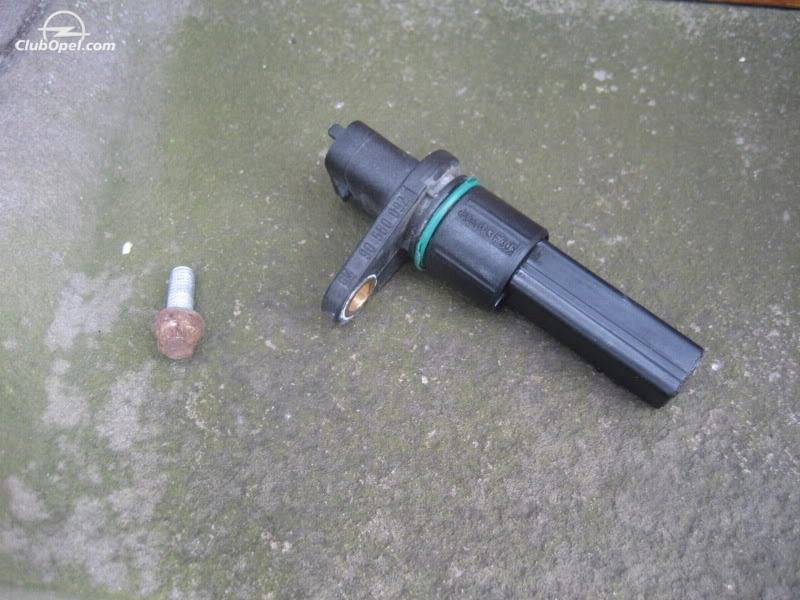

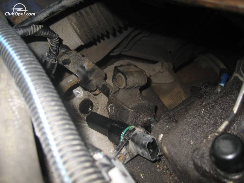

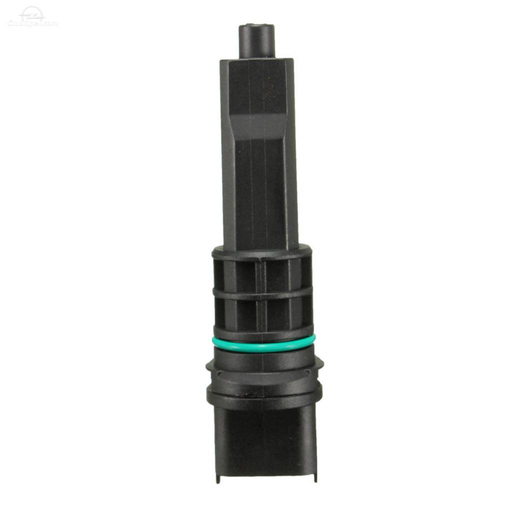

ottosump a scris: Location of Gearbox speed sensor & removal advice on X10XE & X12XE engine
Location of gearbox speed sensor highlighted
As a precaution, always disconnect the battery before removing any electrical equipment.Remove the wiring connector, thumb release clip is on the back of the connector (if stiff this can be removed after extracting the sensor) The sensor is secured by one 10mm bolt highlighted in green, I found it easier to get at using a couple of socket extensions with a flexi connector.
Gearbox speed sensor removed. This one was quite stiff to remove, had to do a fair bit of wriggling before it finally gave up.
Sensor in all its glory, note the green seal, make sure that this is not damaged if re-fitting. (This one is clearly damaged)
Apologies if anyone else has already submitted a similar thread, but I couldn't find one with pictures.
Happy motoring to all ! Otto

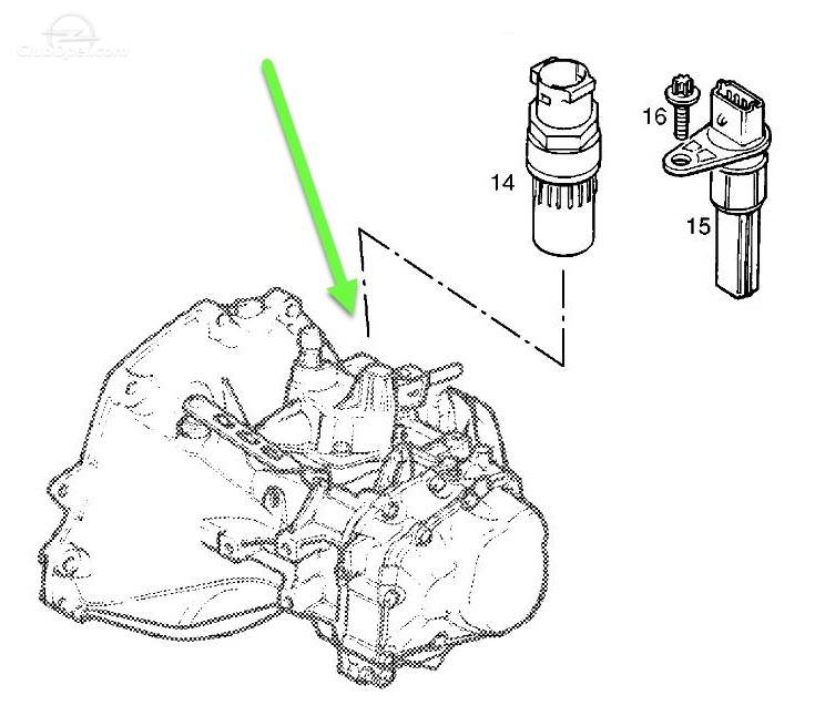

Vezi ce model ai pe masina ca vad ca sunt doua.

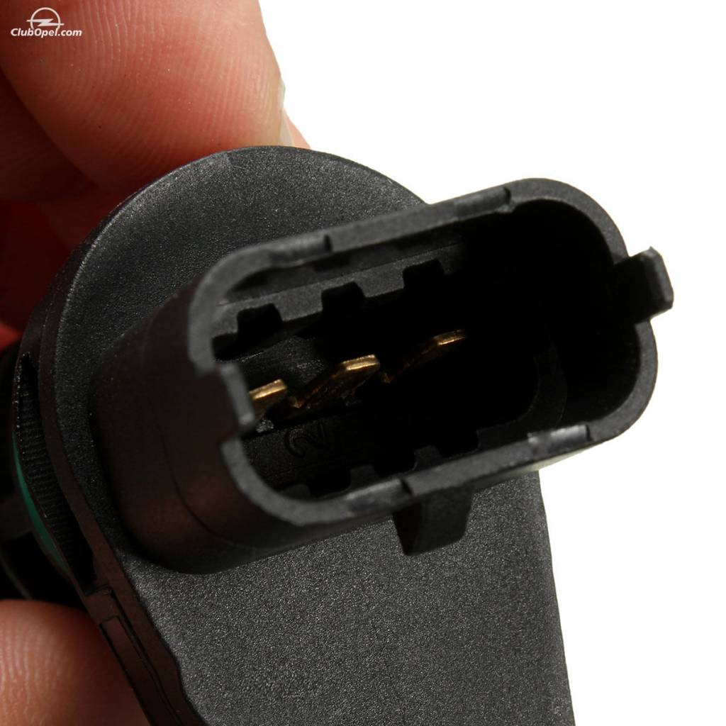

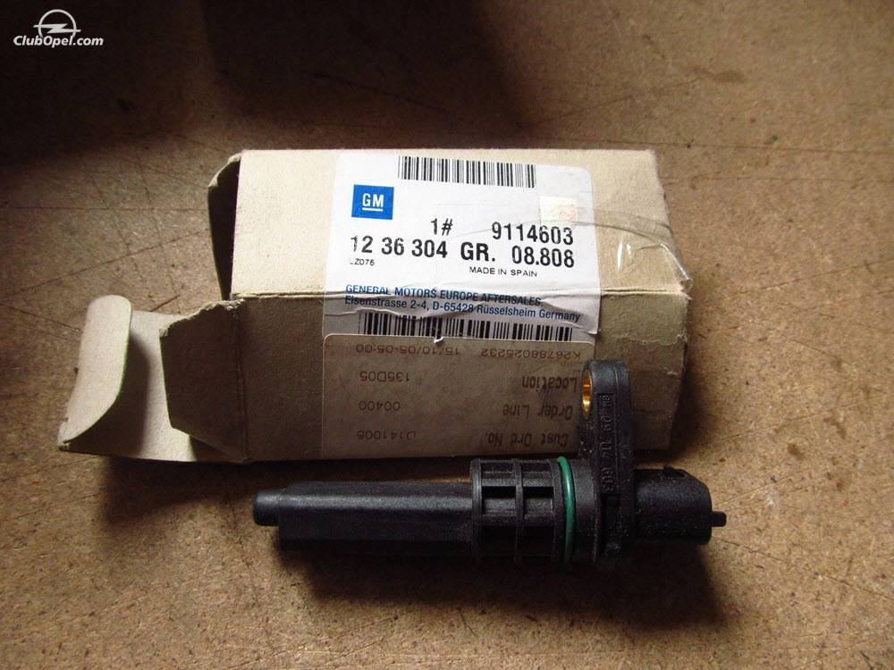

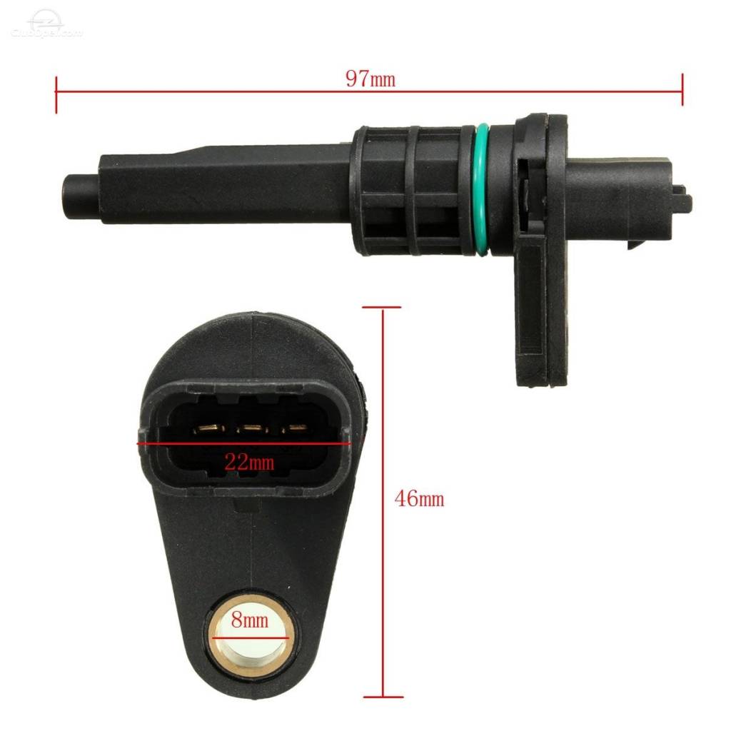

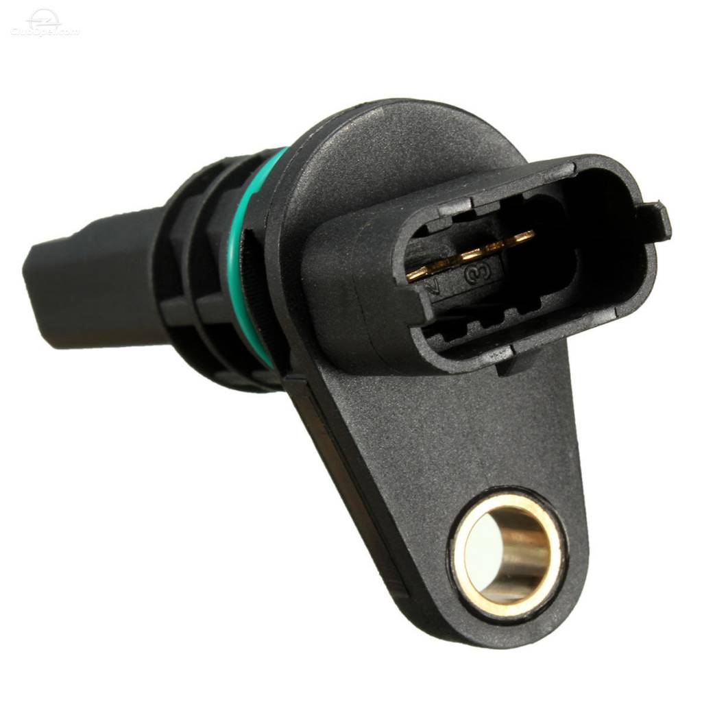

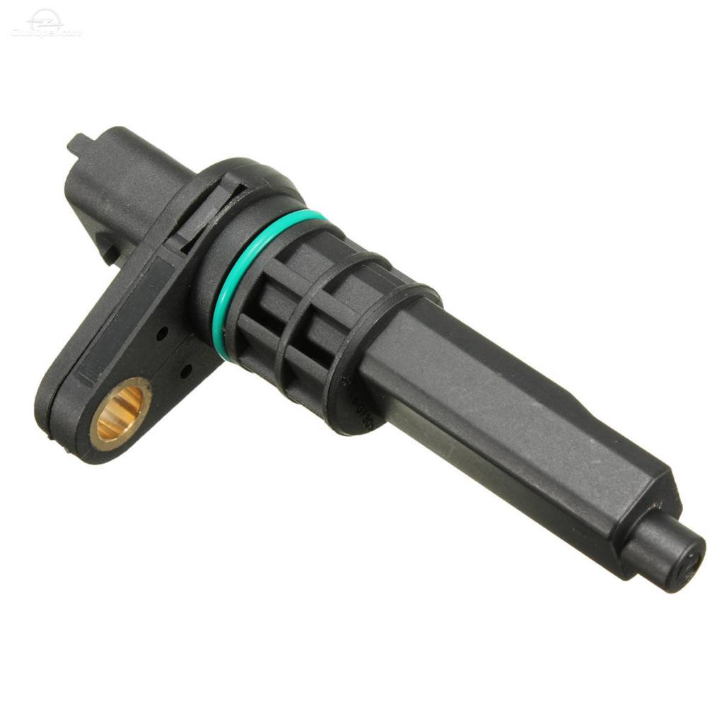

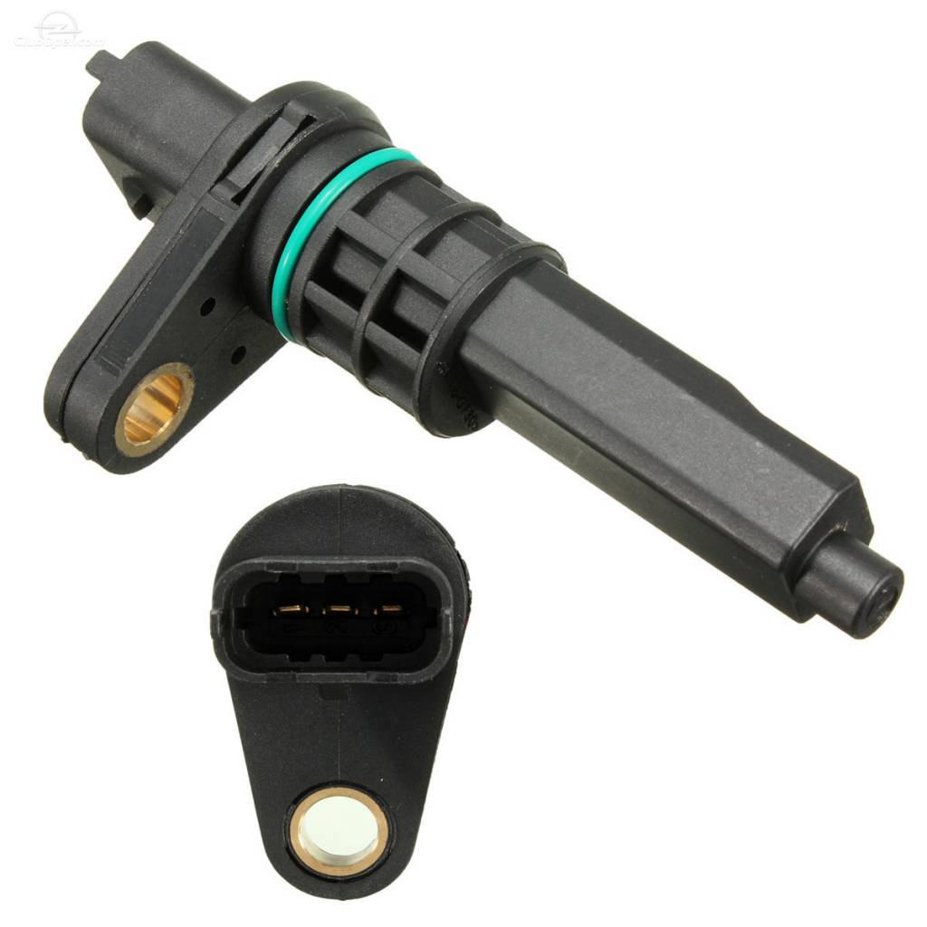

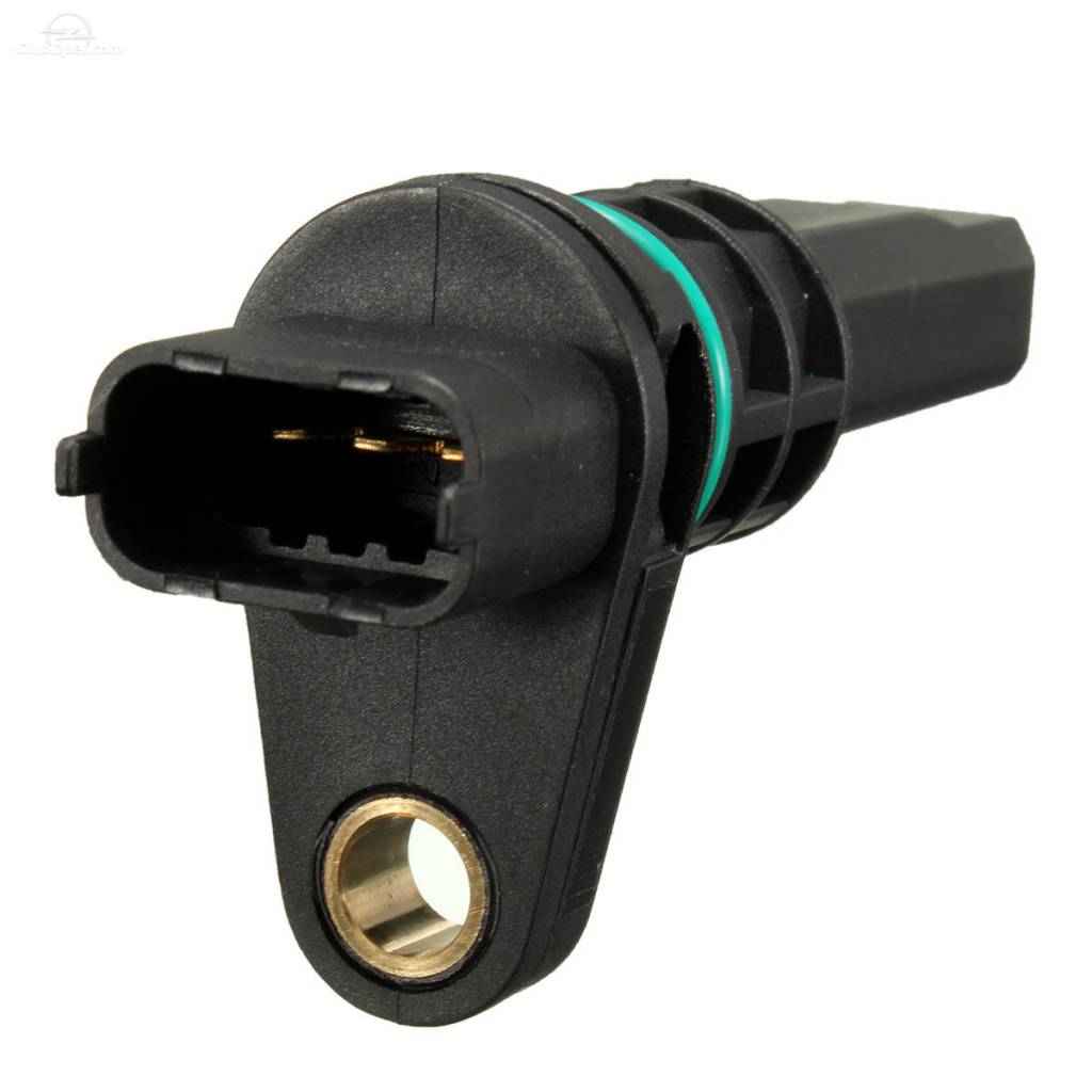

9114603 | 1236304 - TRANSMITTER,DISTANCE FREQUENCY,15 IMPULSES

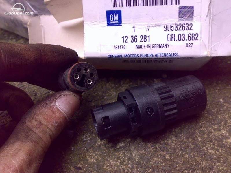

90532632 | 1236281 - TRANSMITTER,DISTANCE FREQUENCY,15 IMPULSES

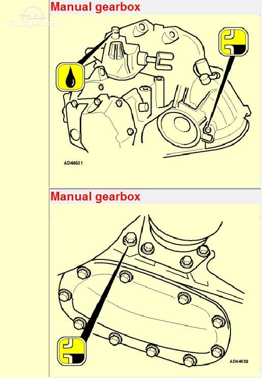

Daca nu ai umblat pana acum la cutie iti recomand sa schimbi uleiul din cutie nici masina nu mai este tanara.
GM 1940182 | ai nevoie de 1.6 L

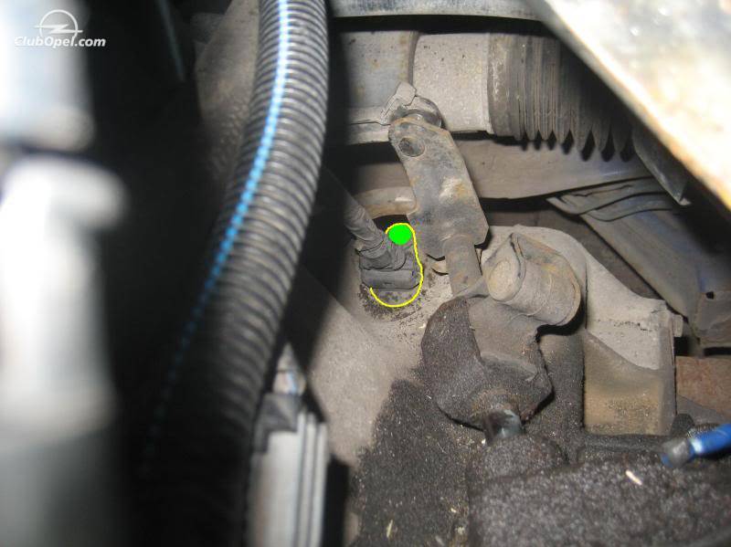

La mine este asemanator ca in pozele tale, dar am facut cateva detalii pe poza: http://imgur.com/a/Yia5K
Se pare ca senzorul este asta: http://imgur.com/a/b7Z8V O sa il scot de acolo si o sa il curat, sa vedem poate merge, daca nu trebuie schimbat.
