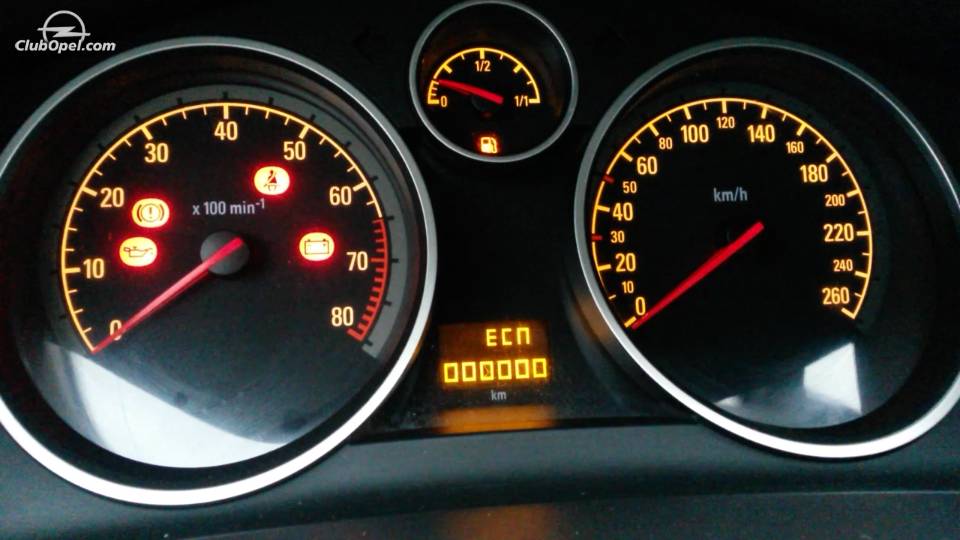

Citeste tu erorile https://www.clubopel.com/viewtopic.php?t=24014

Doar asta a aparut.
