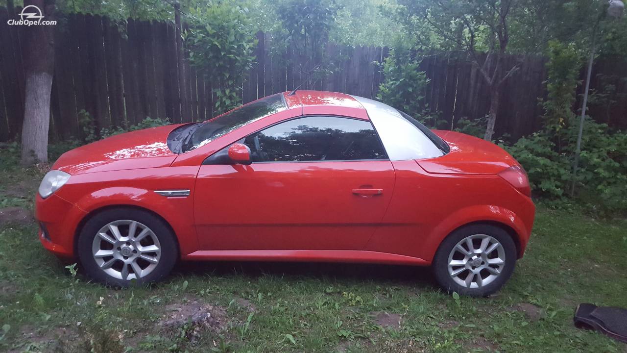

BUNA DIMINEATA,
SUNT NOU-IN CLUB.....
AM O TIGRA ROSIE SI IN CARTE SCRIE 185/55/15 SI 205/50/16 CARE SUNT ANVELOPELE CELE MAI BUNE PTR UN RULAJ DE BUN SIMT (NU NE GANDIM LA ESTETICA SI FRUMUSETE).?
AM CUMPARAT-O CU ARCURI SPORT SI AM REVENIT LA CELE DIN FABRICA PE SPATE SI URMEAZA SA SCHIMB SI FATA...(APROPO SUNT DE VANZARE SI SPATELE SI FATA-ARCURI SI AMORTIZOARE)
CU STIMA ,
I. N.
PS . MAI AM O PROBLEMA PASAGERUL DIN DREAPTA DESCHIDE GEAMUL SI NU POATE SA-L INCHIDA ATUNCI IL INCHID EU DE PE CONSOLA MEA...
