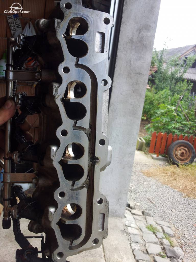

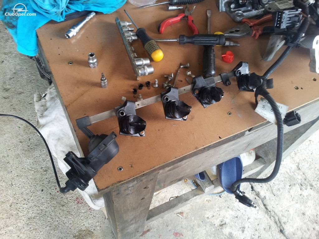

Aceeasi eroare, intai am dat jos blocul Twinport si l-am curatat cu carbusolv, erau ancrasate/colmatate toate canalele de aer de dupa clapete, si clapetele cu un strat de 1 mm de jeg. Dupa operatia de curatare/montare si relipire galerie admisie (zdranganea, vezi topic dedicat pe forum), am montat si eu resistenta pe firul maro. Eroarea a disparut, la fel si fenomenul de lipsa putere in trepte inferioare la peste 2500 rpm.
Hint pt cei care vor sa intervina: demontati tubulatura de admisie aer+debitmetru+suportul filtru aer, astfel aveti acces usor la ramificatia catre potentiometru. Regasiti intr-o tubulatura mai subtire un manunchi de 5 fire: 2 de culoare rosie iar celelalte 3 apartin mufei de interes, respectiv cablurile maro pt un caz si negru/alb pt celalalt caz). Aveti grija la izolarea corespunzatoare, un varnis termic este recomandat.

Salut sa fie asta rezolvarea:
SYSCLEANER
24-12-2012, 08:01
Lot's of time passed but I found the exact solution for twinport error. Actually some german dudes found it and write it on their forum and somebody on my country forums shared and now I'm sharing it with you.
Okey here is the solution:
1.Take out twinport module and clean it.
2.Reach out the sensor at twinport module left side of it.
3.There is two screews which hold this sensor rewind and losen this screews so the sensor can be adjustable.
4.Attach tech 2 your car while every sensor connected (not putted to gether you have still needed to reach 2 screws to calibrate.)
5.Open the voltage check if the port and try to reaching 0.3V by moving sensor and when you reach it rewind 2 screws and fix the position of the sensor.
6.Put together twinport module and intake manifold.
7.Clear if any eror code is existing.
