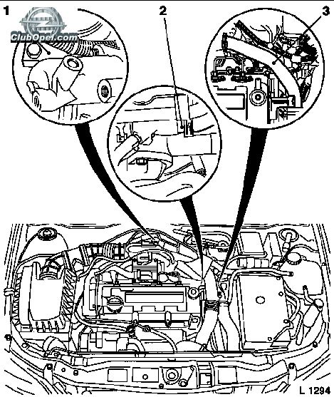

Exhaust Gas Recirculation Pipe, Remove and Install (Y 17 DT)
Remove
Remove air intake pipe (4) – see illustration "Air Ducts" in group "J".
Remove engine control unit (3) – see operation "Engine Control Unit, Remove and Install" in group "J".
Remove engine control unit bracket (2) from camshaft housing cover and exhaust gas recirculation valve.
Disconnect sheathed glow plug connectors (1) from sheathed glow plugs.
Remove bracket for alternator cable bundle (1) from exhaust gas recirculation valve and lay aside.
Remove charged air tube (3) – see illustration "Air Ducts" in group "J".
Remove lower engine compartment cover.
Remove coolant hose (2) from thermostat housing – collect coolant.
Remove exhaust gas recirculation pipe (1) from exhaust manifold and exhaust gas recirculation valve.
Remove bracket for exhaust gas recirculation pipe (2) from cylinder head and remove exhaust gas recirculation pipe.

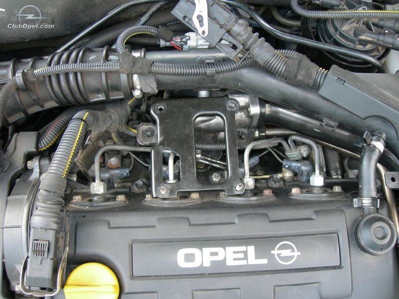

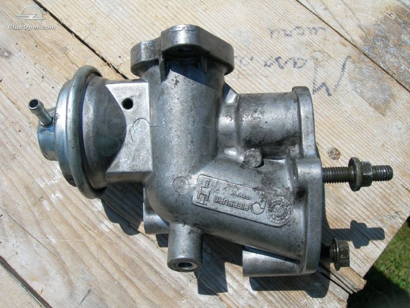

Am curatat valva EGR la motorul de y 17dt.
A durat cateva ore bune.
Masina mea NU consuma ulei. Are 122 mii km.
Am curatat valva mai mult din curiozitate.
Asa arata din laterala:
Demontezi calculatorul
Demontezi suportul calculator
Demontezi conductele ca in postul de mai sus.
Demontezi valva EGR si vezi galeria de admisie imputita

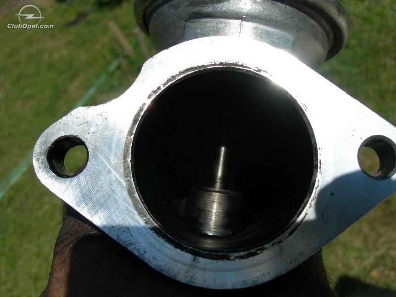

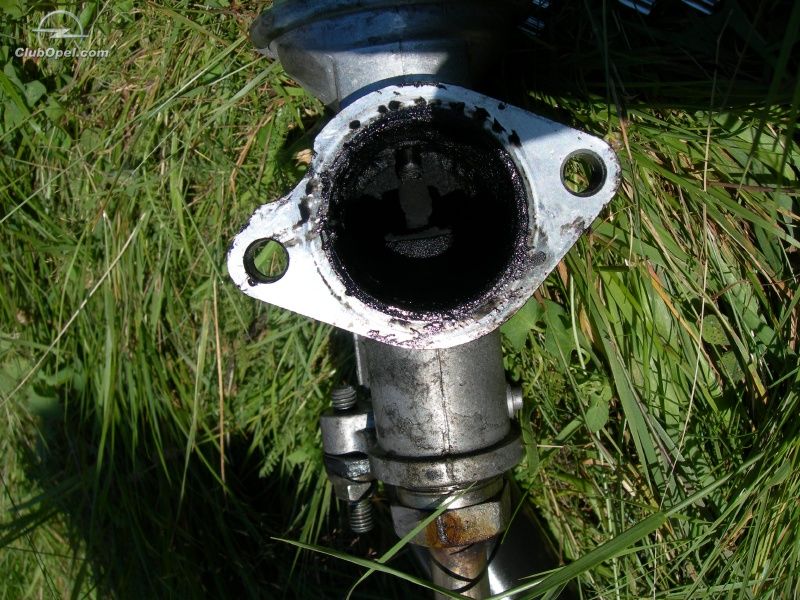

Asa arata pe interior valva EGR imputita:
Asa arata dupa ce o cureti:

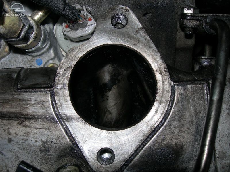

Galeria curatata arata asa:
Montajul e la fel in sens invers.
Nu recomand celor care nu au indemanare sa incerce. La motorul de 2L se curata mult mai usor.

Concluzia mea dupa ce am desfacut valva este urmatoarea:
-Testezi daca valva e blocata inchis nu se incalzeste teava metalica ce iese din galerie. (asta in primele zeci de secunde dupa ce pornesti motorul)
-Testezi daca valva e blocata deschis astfel:
strangulezi furtunul, (nu il scoti direct, daca il scoti dezechilibrezi vidul in toata masina) nu ar trebui sa se incalzeasca teava (care iese din galerie) in primele zeci de secunde cand pornesti masina, evident cu motorul rece.
Teava care iese din galerie este :
gas recirculation pipe (1) in imag de mai jos

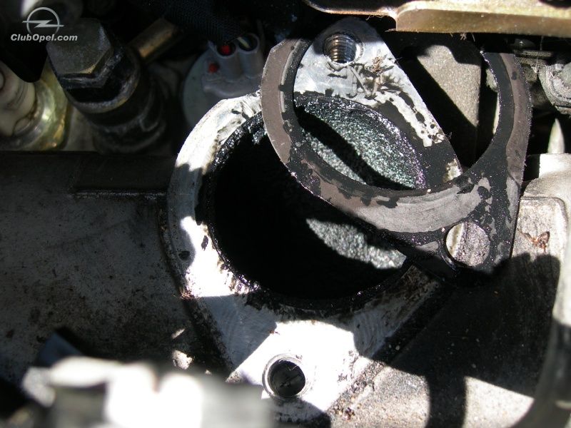

Am reusit sa curat si valva EGR. Eu am desfacut destul de multe ca sa ajung la ea (baterie + suport, filtru aer + debitmetru, calculatorul + suportul acestuia, furtunul de admisie ce merge la turbina, teava dintre intercooler si EGR, teava de recirculare a gazelor arse). Desi am dat jos atatea Very Happy, operatia a durat vreo 3 ore (demontat, curatat, montat). Am gasit pe valva o pasta neagra pe care am curatat-o cu benzina. Am curatat si galeria de admisie atat cat am putut sa bag mana.
Daca se simte ceva in mersul masinii?? Nu stiu.. deocamdata e vremea urata si nu am chef de iesit din casa..
Am facut cateva poze, insa nu prea multe pt ca eram destul de negru pe maini si nu prea-mi venea sa ma apropii de aparat Very Happy..
1 - pt cum se da jos bateria si suportul am explicat aici
2 - capacul filtrului de aer + debitmetrul se desfac destul de usor (4 cleme + 2 coliere)

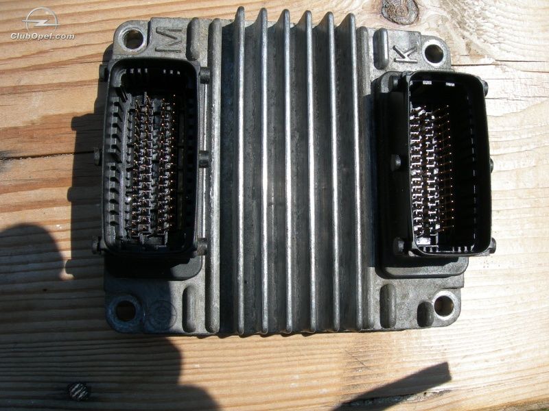

3 - calculatorul de injectie e prins in 4 suruburi (2 se desfac cu cheia de 10, 2 cu un imbus)
4 - suportul calculatorului este prins in 3 suruburi (1 se desface cu cheia de 10, 2 cu cheia de 12). In poza de mai jos am indicat locul unde se afla acestea.
5 - furtunul dintre filtru de aer si turbina e prins in 2 suruburi si colierul de la turbina (sagetile rosii in ultima poza)
6 - teava de admisie dintre intercooler si EGR: se desface colierul de prindere de la intercooler si inca 3 suruburi: 1 pe chiulasa si 2 la EGR (sagetiile albastre din ultima poza)
7 - teava de recirculare a gazelor arse e prinsa in 2 suruburi de galeria de evacuare si cu o piulita mare de EGR (se desface cu cheia de 30). (sagetiile galbene)
8 - valva EGR e prinsa in 2 suruburi de galeria de admisie.

@zildan
@roadrunner79
pentru ambi , amindoi Laughing , multumiri multe .
Datorita voua am reusit si am desfacut valva EGR si am curatoat-o .
De mare ajutor au fost pozele voastre
As mai recomanda atentie mare la pozitia cum desfaceti calculatorul .
Pare pus invers . Deci atentie marita . NU am avut curajul sa-l pun invers .
Adica sa se vada corect K si M !
Atentie la pozele lui @roadrunner79
