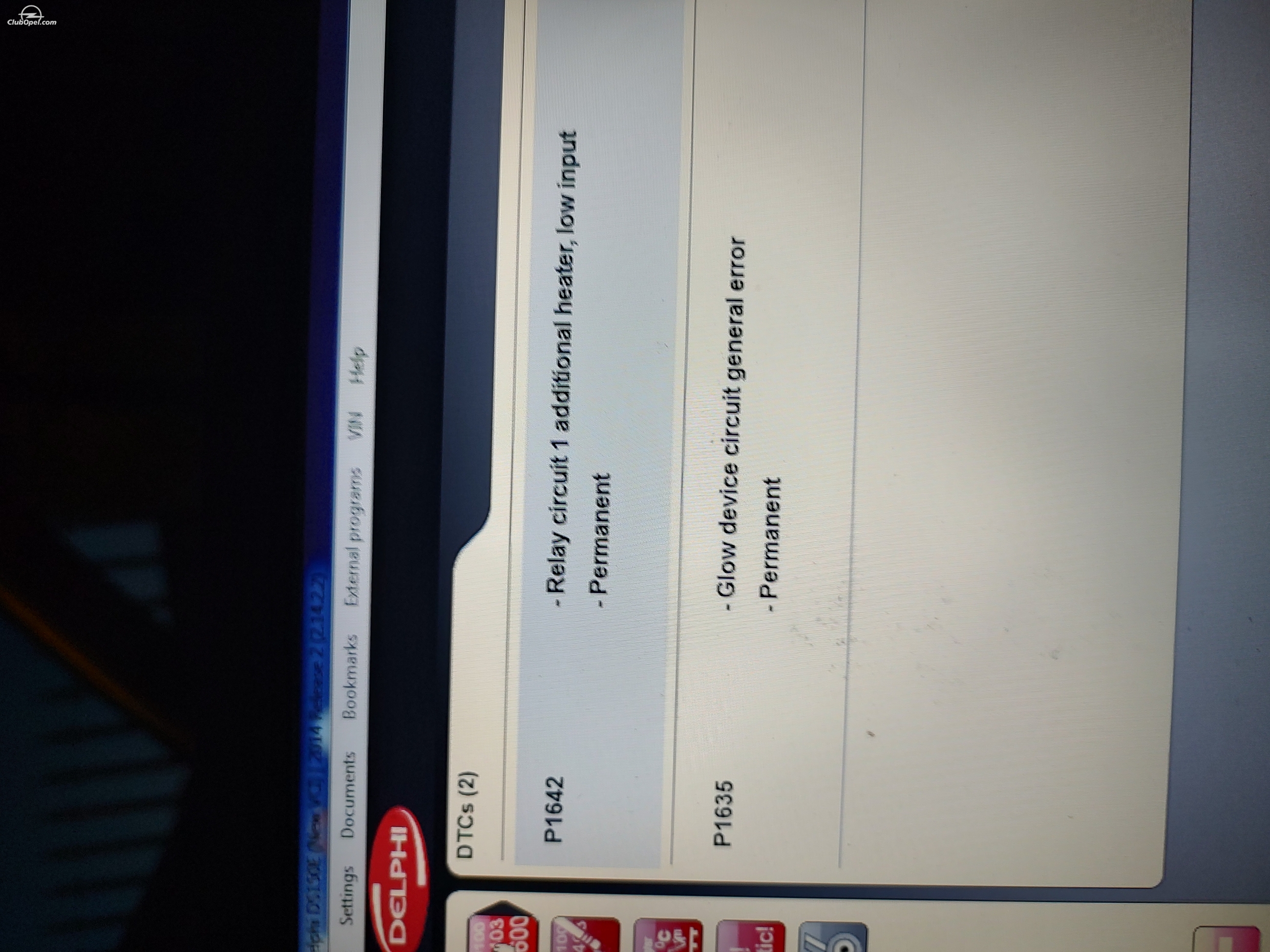

Am si eu un opel vivaro din 2005,si am o problemã cu ea.Atasez mai jos o imagine cu codurile de eroare.
Ideea este ca masina nu mai trage cu trebuie iar daca o forțez pe depãșiri imi apare in bord martorul cu rezistenta si masina nu se mai accelereazã.Daca o opresc si o repornesc merge,dispare martorul.
Va mulțumesc!

p1642 - relay circuit 1 additional heater, low input permanent
p1635 - blow device circuit general error - permanent
Referitor la a doua, am gasit discutia asta: Eroare P1635 la Y20DTH - solutia a fost schimbarea bujiilor (grija sa nu se rupa la demontare).
Referitor la prima, nu am gasit mai nimic pe forum iar pe net doar asta la Renault:
P1642 Renault FC Relay 2 And 3 Control Circuit
Possible causes
– Faulty Cooling Fan Relay
– Cooling Fan Relay harness is open or shorted
– Cooling Fan Relay circuit poor electrical component
Symptoms
– Engine Light ON (or Service Engine Soon Warning Light)
– Cooling Fan not working
P1642 Renault Description
Ignition voltage is supplied to the Cooling Fan relay coil. The Powertrain Control Module (PCM) controls the relay by grounding the control circuit via an internal switch called a driver. The primary function of the driver is to supply the ground for the component being controlled. Each driver has a fault line which is monitored by the PCM. When the PCM is commanding a component ON, the voltage of the control circuit should be lo (near 0 volts). When the PCM is commanding the control circuit to a component OFF, the voltage potential of the circuit should be high (near battery voltage). If the fault detection circuit senses a voltage other than what is expected, the fault line status will change causing the code to set.
The relay is used to control the high current flow to the cooling fan motors. This allows the PCM driver to only have to handle the relatively low current used by the raly.
https://www.carobdcode.com/p...3-control-circuit
Deci daca nu ai incalzire auxiliara, ar trebui verificat releul ventilatorului de racire.
Sper sa aiba altcineva un raspuns mai solid.
Daca gasesti solutia, sa ne-o spui si noua.

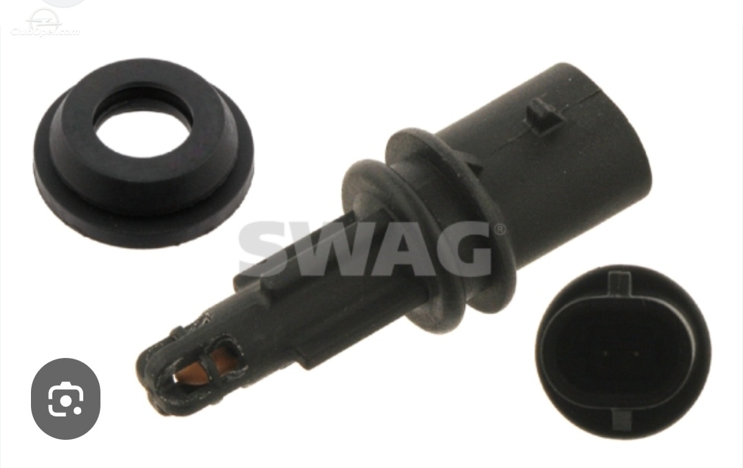

Vă salut si imi cer scuze daca nu am postat unde trebuie. Am eroarea 0110 care, din cele citite pe aici, este de la debitmetru. L-aș scoate sa il curaț, dar nu stiu cum sa îl scot pentru ca nu este prins cu suruburi (cum am vazut eu pe youtube in niste tutoriale de curatare) cu este infipt in tubulatura aceea dintre fitru de aer si clapeta de acceleratie... prin in niște bucati de cauciuc moale. Stie cineva cum se scoate acest senzor?
Daca era modelul cu cele 2 suruburi, era simplu de scos... Nu am gasit nici un tutorial cu un astfel de senzor. Incerc sa atasez onpoza cu senzorul pe care il am eu.
Am Opel Corsa C 1.4 benzina - 2003.

De citit: https://www.clubopel.com/vie...r=asc&start=0
Pe viitor fă o căutare!
